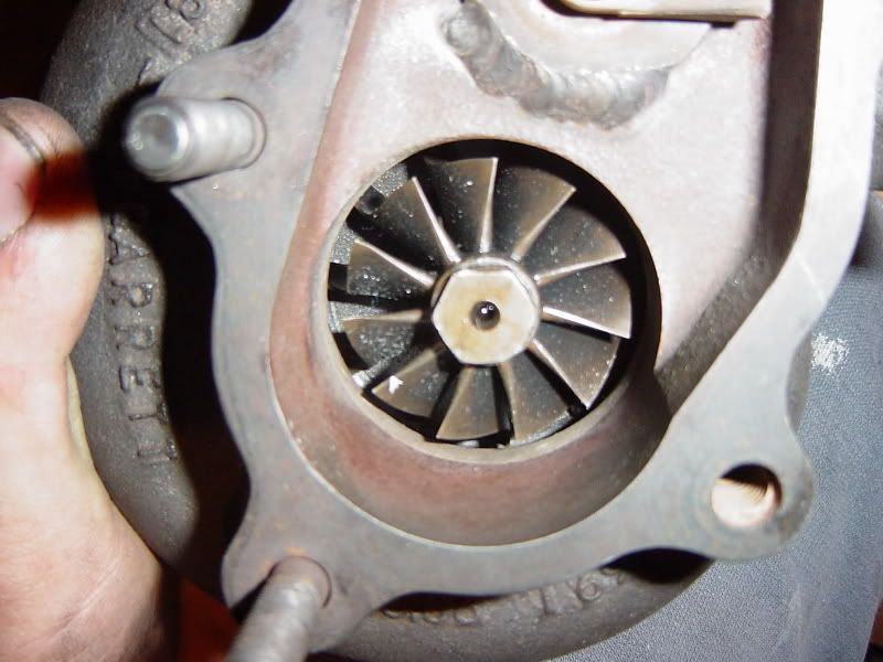

    I ran a GTiR Turbo and modified the .64 housing to take the bigger GTiR wheel,
    and kept most of the response for a good result in power in the higher RPM ranges.
    was 200Kw atw with that.

    Dude, the GTiR wheels are the same as all the T28's, it's just the exhaust housing is larger. We've measured.
    Remember that the S13 came with the T25G not a T28 which had smaller wheels.

    From what I know the turbo I had was a NON-bb off an S15 blacktop?
    Anyway, here is the wheel that was on it with the .86 housing you can see the difference in the picture,
    I used the wheel meant to be in that housing, with the .64 housing I that was on it.
