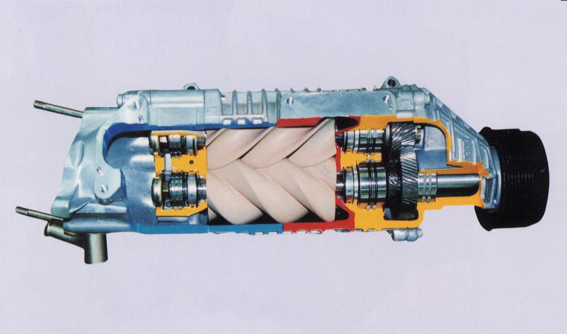

    sweet, found it thanks! (no details, but a pic)
    http://www.ihi.co.jp/ihk/seihin.htm
    a lot of th elength seems to be "not rotor"
    ooh that pic is bigger than i thought
    ok so here is the skinny....
    mazda S76 charger 1.65L/rev
    AMG S105 charger 1.6L/rev
    output of both : 18M^3/min
    they put out the same amount of air... the mazda charger is much less efficient than the AMG.
    the amg can push out 21M^3 and can run at 21000 RPM's
    the mazda already runs at 21000 rpms and puts out 18 M^3
    the S120 from the V8 mercedes puts out 3.0L/rev
    800 hp capable...
    the other 2 are 450 hp capable.
    mazda and AMG take 55 hp to drive at max rpms.
    make sure you have a large intake to keep the heat down.
    how does this compare to the 1200?
