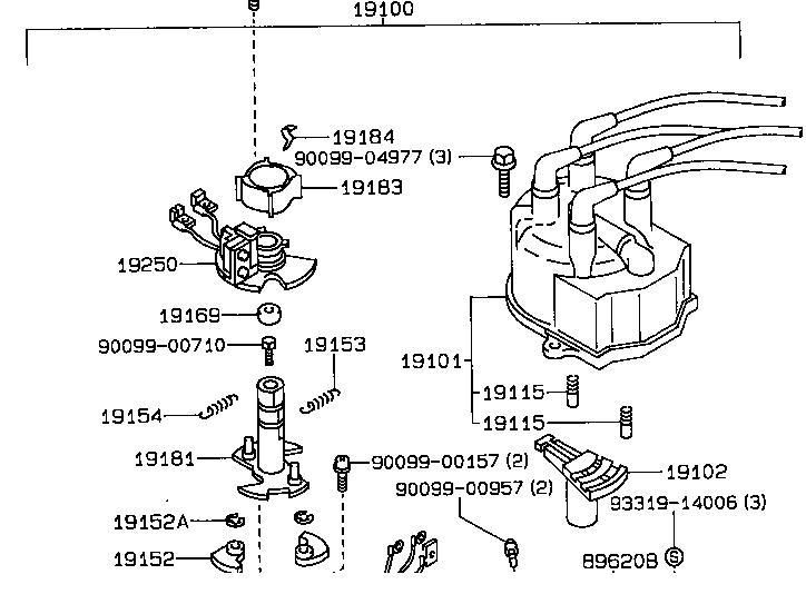

    That number doesn't work in EPC but did the dizzy look like this?
    Victoria, Mt Macedon
    1,134
    Default Re: 4AGE carbed dizzy - EPC request
    No, not like that. It didn't have an inbuilt coil. It just looked like a normal round dizzy cap. It could well have been non-Toyota I suppose.
    Thanks for looking it up though. Is that dizzy you've shown an option for this setup?
