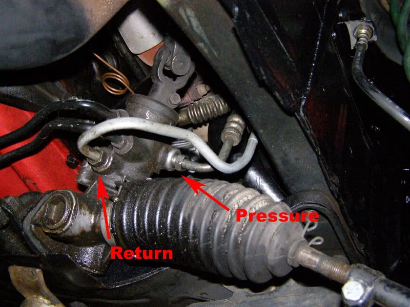

    trying to put powersteering back on a ma61......just trying to figure out which ports on the steering rack are the pressure side and the resevoir return port....
    there is one port on the rear of the pinion housing and the other port is on the drivers side.....any help would be greatly appreciated....

    this help at all? taken from the ma61 service manual

    ill minded....na sorry no good usdm pic to begin and it doesnt show where the pipes go
    negative boost thats exactly what i was after your a legend.....if i can figure this rep thing out your gettin some!

    Negative boost : curious : what is the copper tubing in the background for?

    That copper line is for my mechanical oil pressure guage. Runs from an oil gallery just below the turbo into the cabin A pillar. Its about 2m long i think!
