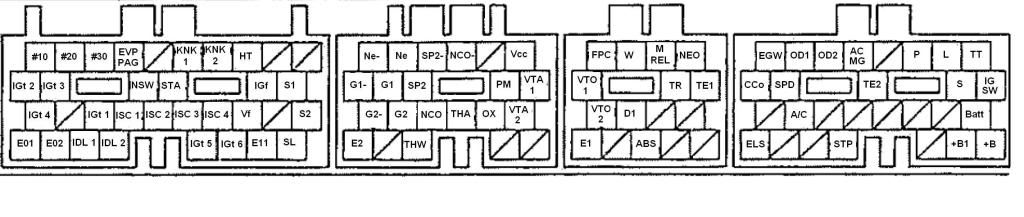

    It was originally stalling everytime id shift from a driven gear back to neatral or park so I hunted down the 2 wires i'm pretty sure are the NSW. One has 9V in p&n and 0V in gear.The other also has 9V in P & N and 11.3 V in gear. I connected the 2 together and it stopped stalling when picking gears but it definately still cranks in any gear so its not right. My info says to connect these 2 wires to a the 85 and 86 pins of a 30A relay then connect split the starter wire and connect to 87 and 30. I cannot get this to work. Have tried numerous configurations of this with no success either. Yet if i undo the realy and connect back up how I had it, then it goes back to working but in limp mode im suspecting.

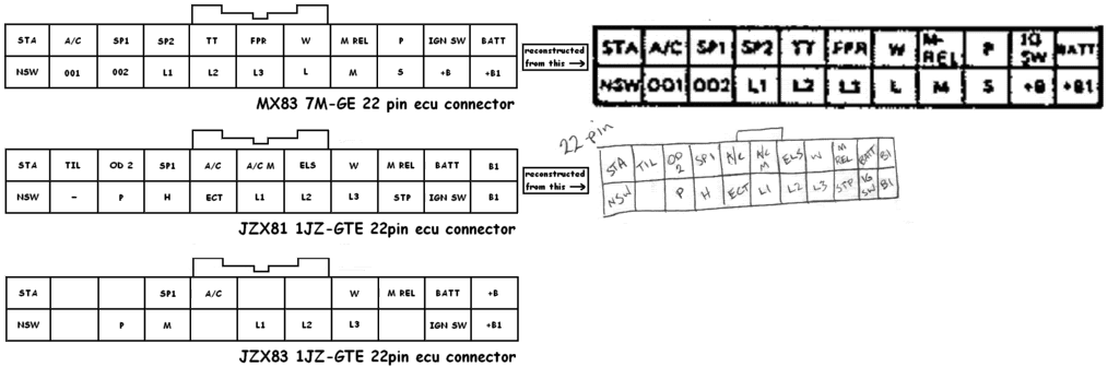

    The pic below is the jzx90 ecu pinouts. On the left hand side you can see the NSW and STA pins. These wires run through the jzx90 engine loom. They come out on the same plug as the injector power/starter motor wires do behind the glove box. Pretty sure it's a grey plug. Do a continuity test to make sure there the right ones. Now on the pic below of the mx83 connecter you'll see the NSW pin, find that wire on the mx83 connecter and wire that to the NSW wire in the jzx90 loom.
    Now connect the STA wire in the jzx90 loom to the ign/trigger pin on a relay (can't remember what the exact pin number is). Then hook the ground on the relay to the body. Your best off running a wire from the battery for the power in on the relay. Then connect the power out to the starter motor wire.
    I hope this makes sence to ya, just ask if ya get stuck.

    Well she goes like she should now. Like a shower of shit. Thank you so much for your help everyone who has posted with suggestions and special thanks to triptek. Following this info has sorted the huge problem i was having and made me remember why i wanted a 1J in my car so badly.
