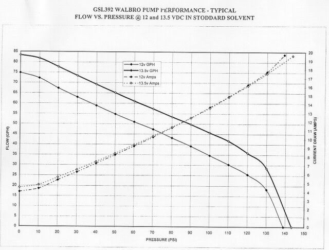

    What are your pump's flow rates at full pressure.
    Excited Member Grease Monkey thomasbl's Avatar
    vic
    175
    Default Re: Using standard ra28 fuel line as tank return from 1G rail.
    This is the walbro high pressure pump. Ill hunt around and find the Pierburg specs.
    Found em..
    Its part no. 27-21443.
    6.3-8.1psi.
    100litres per hour @12v.
