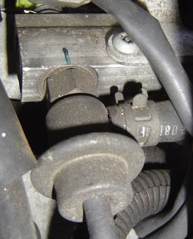

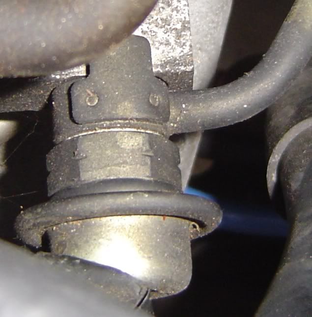

    These are the fittings on the fuel rail. The rear one, with the metal line does indeed look like a banjo fitting, which is held in by the reg tightening on it. The return one however, seems to be a barb integrated into the reg. Or am i missing something?

    I know this is getting dangerously close to the original question but... I used a 8mm to 6mm in line barb reducer. Problem solved. I dont think the difference in fuel temp will make much difference to performance, if any, however, it was a fairly straightforward solution so i went with it anyway.
    Thanks to all those who threw up ideas etc..
