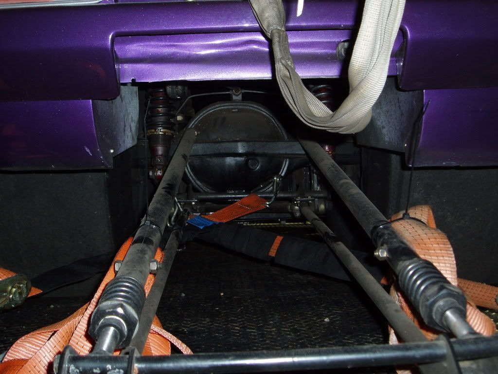

    Well, if drag racing really is your thing, I guess it depends how nasty your going to go. If your going to do something like this:
    Then you may need a diff like this:
    But as said, if your staying aspo, go a T series. If your turbocharging, then you need to weigh up your options, F series is lighter and plenty strong, with your choice of 4 and 5 stud available, but you will need to shorten it. G series is indestructable, has massive brakes available, plenty of ratios and LSDs, but can be a bit thin on the ground and is mega heavy.
