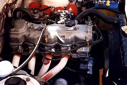

    my 4G54 (2.6L Astron) out of my old Scorpion, headers removed, prepared and painted up in the manner that Ben has suggested above (was a hot day also, headers were hot when final sprayed), and after just 10 minutes going for a run in the car, I pop the bonnet to find all the good work and my bright red VHT (1500*) scalded and turned a frosty white colour instead. thus why I don't trust VHT anymore.

    that looks good though!!!!
    wicked!

    hrmm, well... I couldn't understand why it left some areas the original red colour (around the flanges, the Genie badge, etc.) and turned the rest white though. still got me stuffed.

    heat? or maybe it was really hot, and the white areas copped cool air and it cooled down too quick? who knows.
