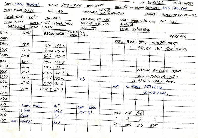

    Default Re: xT Series Engine Variants
    Engine model and generation:
    2TG/3T Hybrid Early 2TG Block late Head 88261
    Top End Modifications:
    Oversize Valves
    401A Camtech grind
    Head Ported
    Bottom end modifications:
    Endrotech Pistons (machined to suit head)
    Hasting Rings
    3T Crank Block machine to fit the Crank
    Management:
    Spark Only Via Jaycar Igntion Kit Mk2
    Fuel used
    BP Ultimate
    Intake:
    Dual Side Draught Solex 40PPH Carbies S4
    Jetting
    M 135
    MA 170
    P 60
    Starter 180
    Pump Nozzles 45
    Note: Current Flat spot on street driving update jetting on fixing.
    Ramflo foam style air cleaners
    Custom balance pipe
    Exhaust:
    4-1 Extractors
    2" Exhausr System
    Driveline:
    Heavy 3TC Flywheel (approx 12kg)
    Clutch HD Exedy
    Stock T50
    Stock Diff

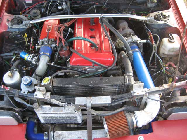

    thought people would be interested in a friend Eric Budd's 3tgte te71 racecar in NZ
    power 197rwkw @ 7400rpm, 640nm from 4800 to 6500 all on 16psi
    compression 140-145psi
    3tgte
    88260 2tgeu head, reground 2tgeu 88261 cams, lengthened valve stems, harder outer valve springs.
    stock 3tgte
    Forced induction:
    custom T3/T4 turbo, evo intercooler, racepro BOV, Tial external wastegate
    Management:
    Link lem1 (old)
    Fuel used
    98 octane(?)
    Intake:
    2tgeu intake, adapter plate w/ mitsi evo throttle body
    Exhaust:
    3" exiting before rear wheels
    Driveline:
    w57, hilux rear, 2-way lsd
    -Mark
