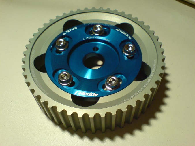

    ok well this doesn't really help much (in regards to getting people to realise they don't need the bling) but i got bored last night and started playing in solid edge making some adjustable cam gears. basically, they're made without any measurements, so they aren't for any purpose, but if someone gave me some measurements for a set of gears, i could adjust/redraw them to suit.
    in any case, the picture still looks sexy
    576
    Default Re: TRD 4AGE cam gears- Indexed (and 1JZ)
    Looks almost identical to my Greddy cam gear
