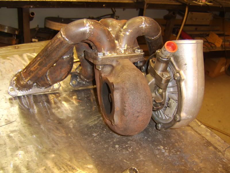

    said turbo
    looks right at home on the ol log.... haha

    the turbo's i was looking at as the post title airresearch t04, went to the cousins today and got one that had been re-stamped Garrett (as pictured), is .60 a/r comp and .84 a/r ex, T04B.
    from what i can find on this model it might be ok for what i'm after, i'll give it a go on the twincharge i'm playing with, see how it goes anyways. no harm in trying.

    Those "Diesel" turbos are succesfully used and modified in Finland. Just about everybody that I know personally uses some modified turbo off from truck, tractor or so... Most common turbos are Garrett, Holset and Schwitzer's.
    Normally wheel sizes, trims and AR ratings are bit weird to start with.
    Like Garrett that I have came from Scania truck. This turbo had 55mm compressor wheel and 65mm turbine wheel. AR was .100 or so. Now it has 60mm compressor wheel and AR is .70. Turbine side stayed the same. Trim was also slightly changed.
    This should be good for 600hp...
