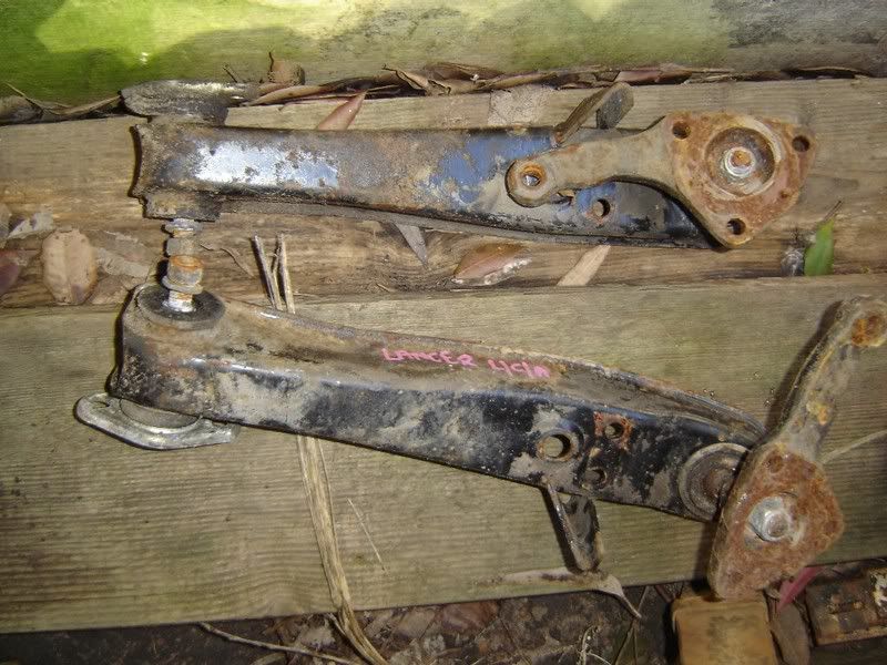

    If the RA28 is like most other toyotas of the day LCA wise, you'll need the GH sigma arms. I couldn't tell the difference between sigmas at the wreckers so i was checking the build plates on the firewalls. There's some sigma (forgot which model) which has funny as bushes which wont work with brackets on the crossmember for the LCA, thats why you use GH arms and cut the bushes down to fit. Here's a thread for fitting them into the MA61, the pics might help you visualise.
    Edit: and here's a picture of the wrong sigma LCA. Note the bush, its a 2 piece which simply falls apart. And also the bump stops, my GH arms didn't have any bump stops.
    I'd measure up a GH ball joint taper and also a stock RA28 taper. If the taper on the GH ball joint is bigger than the RA28's, its simply a matter of reaming out the steering arms on the RA28 to suit the GH ball joint. Might want to grab yourself a spare pair of the RA28 steering arms just incase you want to go back to stock.
