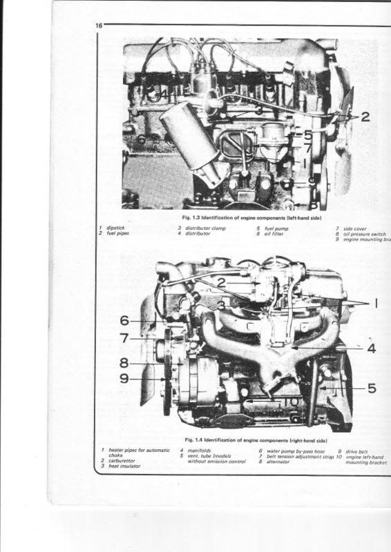

    I think I have solved the question of the "extra oil drain cover thingy"
    having a look at an early 18r picture as seen below,the engines that had absolutely no polution gear had a crankcase breather in the location you descibed. Maybe in later blocks they put a cover plate over this breather until they had used up the early block castings.
    Look at the picture below and item 5.
    Cheers Dave

  9. #654
    3,164
    yeah you definitely have an early 18R block converted to 18R-G.
    that crankcase vent on the exhaust side is complete sealed in the casting on the 18R-G blocks i have in the garage.

  14. #659
    749
    The very early 18r and blocks had no pollution gear, maybe not even a pcv valve, hence the crankcase gases were vented to the atmosphere by the item no 5 in the lower picture I posted. I would suggest that if you have a pcv valve on your 18rg you can dispence with the early type breather. PCV valves are designed to cause a negative pressure in the crancase to remove fumes from piston ring blow by and recirculate them into the intake manifold.
    Cheers Dave
