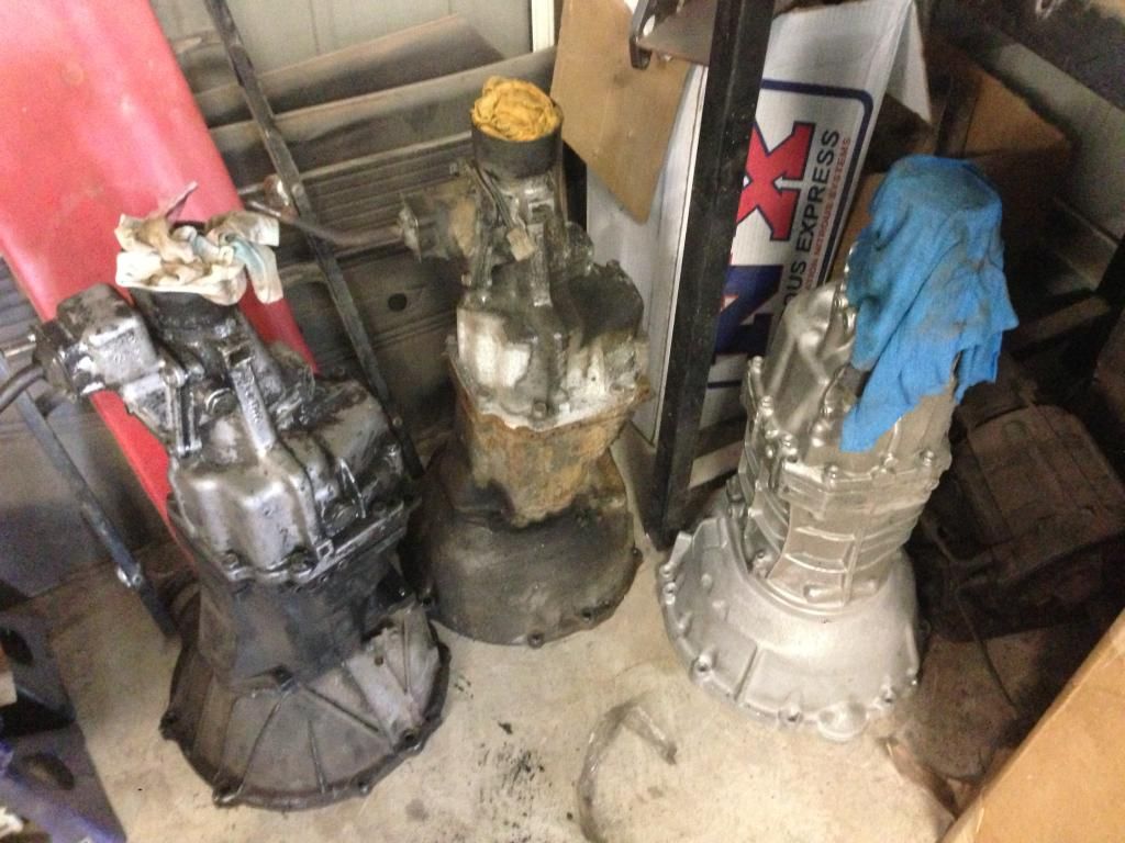

    Hey Justen, do you know about the ratios for a fact or is that a guess? I would have thought that but i cant find anything that supports that. I can only find one set of ratios for W50.
    I dont even know if the gearbox was original fitment to a hilux or it was just in one previous to being removed. I apparently the bell housing on these gearboxes in the ra40 celicas had the ribs like the one i have so the gearbox may have originally come from a later model celica. Thats why i was hoping there was some way i could know for sure based on the part numbers but alas my searching has been in vain.
    here is a picture of my collection of boxes so far:

    hey Damien,
    the W50, W52, W55 and W56 all found their way into a hilux of some sort. I confess my knowledge of ratios only comes from driving the things but i guess the short ratio feel could easily have been the diff ratio? A quick Wiki check suggests the ratios didn't go significantly shorter until the W56.
    Just go a W58 and be done with it

    The silver box in that photo above is a w58. i dont know the condition of her internally but it selects all gears and sound okay when rotating. The plan was to just check over the rg and do bare minimum to get it up and running. Slap a w50 on the back and chuck that in the celica. The plan was to then rebuild the rg down the track, clean up the ports and either try and track down some higher comp factory pistons or design my own set and machine them up from some forged billet. If or when i get to that stage i was gonna throw the w58 behind it.
    however if getting a working w50 behind it is not as easy as planned then i will probably just skip straight to putting the w58 in it. As a bonus this box has the steel bearing plate which, from my quick inernet research, apparently makes it worth more even though they say is doesnt make them stronger. They have shelves of these things pulled apart at bullet from when they used to run then behind the NA bullets so even if this one needs some parts im sure to be able to fix it up without too much trouble.

    The steel plate one is stronger. The plate, being the main gear set carrier, is more rigid and helps alleviate any alignment issues big torque setups can cause. Not that it saved the W58 I was running behind the UZ
