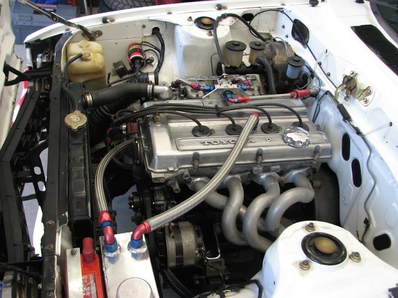

    What do you want? an original cast manifold or a set of extractors.
    Hardiman Performance in Milperra Sydney can supply the extractors and ship them over to you in NZ.

    The original manifold was my first thought. What type of difference will the extractors make on this engine? I've just contacted the Redline distributor in NZ to see if they stock them. Would save on shipping!

    If you are running standard exhaust and engine pipe, the cast iron headers are easy as they bolt up, if you are going a full 2.25" the extractors would be a good fit. The performance difference on a standard motor is bearly noticable, if you are running ported head and cams, good extractors are a must have.
