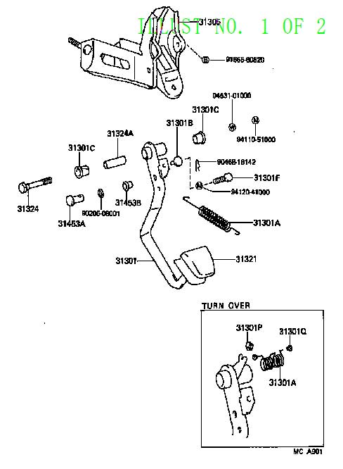

    Check the following plastic bushings for wear.
    31301C
    31453B
    If equipped:
    31301P
    31301Q
    I had to replace them on an ST 165.
    Grease and spray lube won't do anything except make a mess.
