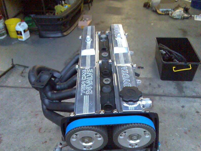

    2,754
    Default Re: 7MGE cam gears interchangeable???
    Quote Originally Posted by 7MA61
    That being said you can buy AEM cam gears for 7m anyway. I'll be getting some once my billets arrive.
    Indeed, ebay is your friend.
    They look like this
