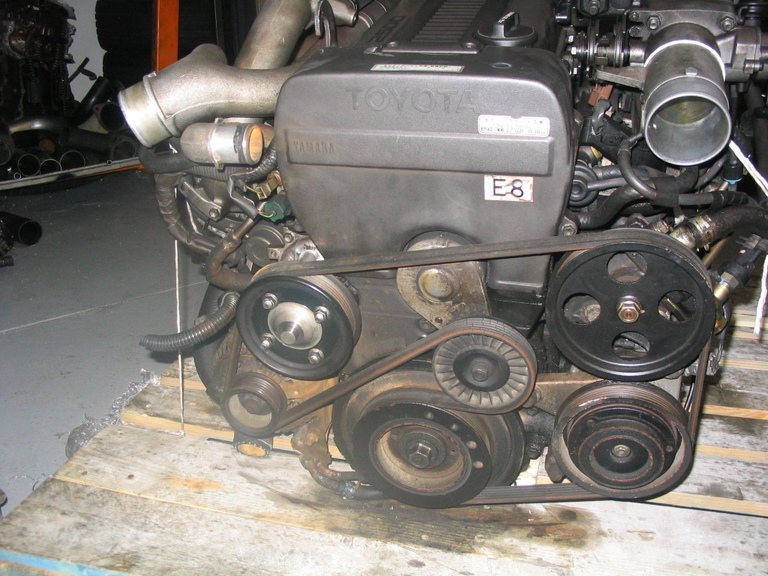

    Default Re: 1jz Belt
    6PK1905 is what you need
    Im using it on my car and its a perfect fit
    Thread it the same way as the pic above, but obviously miss the a/c pump

    576
    FYI the 6PK1900 belt is too long, tensioner is at its limit trying to hold it tight. I purchased a 6PK1875 it fitted perfectly, tensioner marks are spot on.
    Aircon removed...note how close tensioner is to power steering pump when using 6PK1900 belt.
    Tensioner is out of range, note markings.
    Haven't taken any pics of the 1875 fitted up, but the markings are spot on in the middle, lining up perfectly. The rattle from the tensioner pulley disappeared when I put the shorter belt on too.
