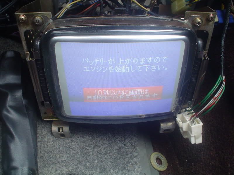

    My one seems to have vertical hold issues. I'll try and track down the problem. I wonder if it will be in the boot box or the dash. Any advice for disassembling the dash?
  5. #50
    Just Soarin' Automotive Encyclopaedia derekjay's Avatar
    1,079
    Default Re: MZ12 Soarer TV
    Haha success! I fiddled around with it, and it came up with vertical hold and everything. But then it beeped a bunch put up a warning message in Japanese, the only word of which I could read was OFF, and then turned itself off. :S I'll have to take a photo of the message if it comes up again and translate it, so I know what is going on.

    Low battery is the message if it is the same as the below pic.
    バッテリーが 上がりますので
    工ソジソを始動して下さい。
    Translates to: "To make battery voltage increase, please start the engine."

    Awesome, that is indeed the message.
