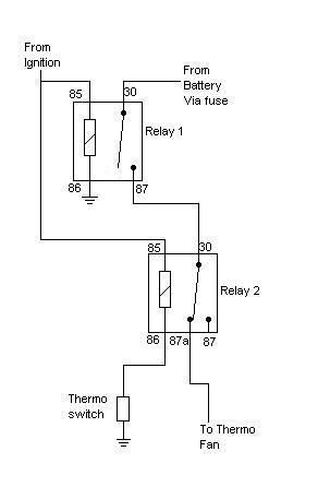

Wire it like this.
You can use your 5 pin relay for relay 1 but you will need a change over relay for relay 2.
Brad

Relay 1 is there to power the thermo from the battery rather than ignition. If you just use relay 2 and connect the 30 terminal to the battery, the fan will turn on when the ignition is turned off. You could over come this by connecting the 30 terminal to ignition but I wouldn't want the extra load on the ignition switch just to save one relay.

Power 85 from ignition and 30 from battery.
His thermo switch is normaly closed, the same as Toyota thermo time switches. Your diagram will turn the fan on when the engine is cold and off when it is hot.
Edit: I apologise, your diagram is correct, however when the ignition is turned off the fan will turn on.

Ergh, if i specified the switch type it would make more sense. That is a DPDT switch, and will be switched to 87 when power is applied and 87a when no power is applied.
Hence when power is applied to the relay (i.e. thermoswitch closed and engine cold) it will switch to 87 which has nothing attached to it. When the engine heats up and the thermoswitch opens, the relay will turn "off" and switch to 87a thereby activating the thermofan.
Correct, and when the ignition is turned off, the relay will turn "off" and switch power to 87a thereby activating the thermofanOriginally Posted by takai
Brad
Old Corollas never die...
My KE30
Updated 15/7/2007............ yes, I need to pull my finger out.
