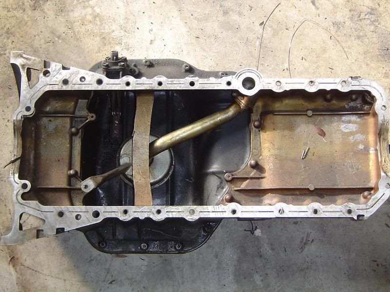

    It came with my motor, may look at selling it, just need to know which sump it is first.

    mid-rear

    that would be rear sump

    mid-rear or rear?
    please only respond with definate answer

    rear (as per jzz30 and jza80)
    true mid rear is as rare as rocking horse shit

    Default Re: Is this a mid or rear sump for 1/2jzgte?
    Quote Originally Posted by ed_jza80
    mid rear (as per jzz30 and jza80)
    true rear is as rare as rocking horse shit
    True mid is rare as rocking horse shite. (not true rear)
    my bad
    its a rear sump you have there
    ex jza80/jzz30 etc
    i just get the descriptions confused

    JZA70's are also rear sump.
    Edit: As it says in your link... lol, forget that comment.

    Hey ed,
    I was under them impression that the sumps were called the following "mid-rear", "mid", "front" (in order of rear->frontness).
    I wasn't aware of a "rear"....i guess it's just a naming issue, but yeah....

    Quote Originally Posted by wilbo666
    Hey ed,
    they call a 7m sump (same layout as 1jz etc) which is a rear really - a Mid-rear....

    well, considering we invented the naming system, i guess we're free to change it to whatever we like. i nominate pink, yellow, and aqua

    whats this true shit
    Its Front
    Mid
    Rear
    thats all there is to it

    Well now that we have established that this sump is "rear" or "mid rear" or whatever, may I ask how many different types there are ?
    3,468
    Quote Originally Posted by Enchanter
    3
    mid-rear (or rear ), most common
    mid, most rare
    front, less common
