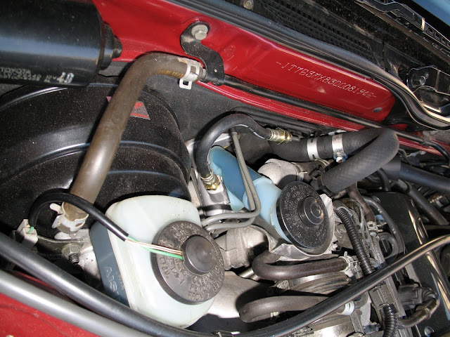

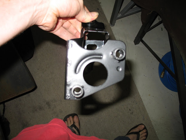

    In response to the master cylinder options, i know of one other that is almost a bolt in replacement - its from a JZA80.
    When i say almost, all that needs to be done is to remove the studs off the pedal box and use the studs off the master cylinder, and then to have the line made up to suit.
    Check out the pics for a better understanding (thanks to cseufert off tc.net)
    Pedal box with studs removed
    Clutch master fitted to pedal box
    Fitted to car
    And just to show it sits perfectly straight
    Close up photo showing line
    For any other pics, and the above in higher resolution - check out his albums at
    edit: just realised he was talking about the jza80 master cylinder, and not the pedal bracket. oops
    In the photo above, that part looks quite different from a JZA80R pedal bracket. 55107-14140 is the part number for that, and if you google it, you will notice right away it looks quite different, the most prominent thing being that it lacks any studs that need to be removed. It also has some...thing on the bottom of the bracket with a threaded hole for a bolt that I'm not sure as to whether it'll get in the way or not when attempting to mount.
    Funnily enough the other day I saw a pedal bracket and pedal on sale in russia, 55107-22190 or 55107-22200. It was gone by this morning. Used clutch masters still seem to be available there though. But who knows for how long.
    55107-22230 is for a JZX90, looks very similar to OP's pic but not exact. Seems like it might work though, but it's no longer in production, only sources now are ebay scalpers.
    55107-22170 is for a JZX100 and also looks very similar to OP's pic, but not exact. Honestly can't see any major differences between it and the JZX90 pedal.
    Both these parts will need the studs removed if keeping the master cylinder studs.
    Clutch master cylinders...there is an interesting thing about the gx81 cylinder: the turbo version is much like the supra turbo cylinder, in that it has a heat shield (31464-22010). It has a different part number (90430-10074) to the NA manual cylinder (31410-22211, superseded w/ 31410-22270), because the NA cylinder doesn't have holes for the two bolts (91611-B0610) that hold the heat shield. The turbo cylinder has an interesting setup in that to get around the head shield, it has a banjo fitting and two copper gaskets.
    If you don't want that though, you can order aisin aftermarket parts CMT-003 and CRT-099. The original parts were CMT-117 (no longer in production) and CRT-007. You can still buy -007 on ebay or whatever but kinda expensive. Buying -003 and -099 is cheaper from rockauto, even with shipping to aus. CMT-003 is originally for a hilux and hilux surf, 1988 models and similar.
    Update: a jzx90 pedal box is NOT bolt in; the top part where it bolts to the firewall/up inside the dash, needs to be bent lower, but this is very hard due to the way the metal is shaped. May need a dremel but that may compromise stability since if this is done, the only mounting points are the master cylinder studs. Thus, the jzx100 box is also likely to not fit without modification.
