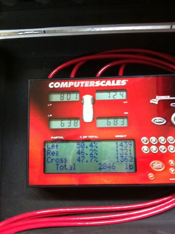

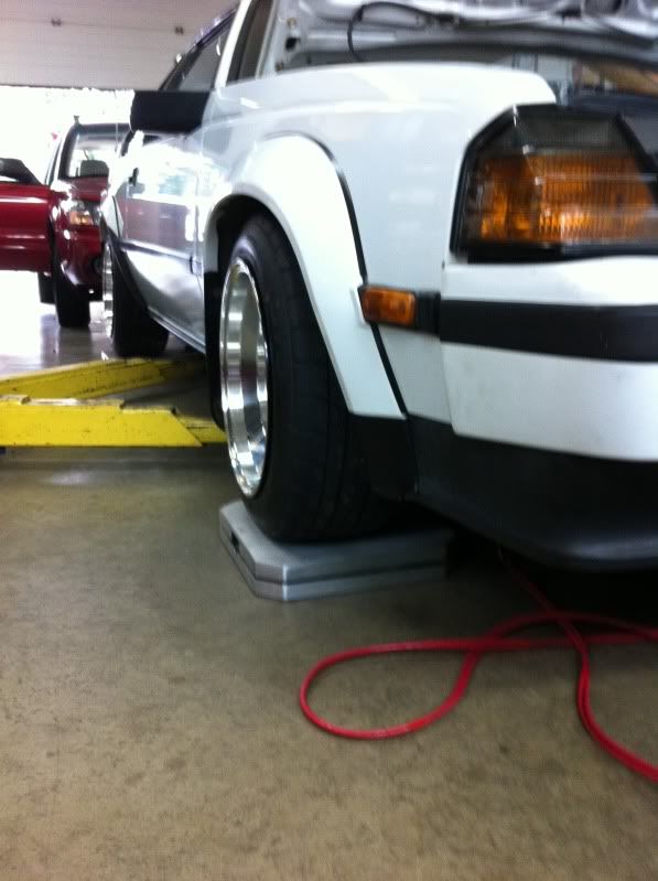

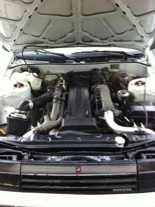

    Recently completed. Not hard to fit the engine and R154, the tough part is sandwiching in all the neccessary cooling. It came out clean and simple though.
    And as far as weight balance being destroyed, this is definately a much heavier setup than a 22r with a w58, but the weight of the R154 is set back a good distance. Feels nice with the Megan coilovers in it. The battery for this car has been relocated to the rear spare well. I wish i had scaled it pre-swap.
