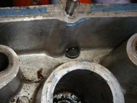

    In the oil drain hole in the back and centre of my 88210 head, there is a plug/metal thing. Is this supposed to be here? It isn't fixed too firmly, and it comes out easily. It's got me a bit confused. I might post up a pic tomorrow.

    You flatter me so! No, the drain I mean is under the rocker cover, at the back of the head. It is in line with the hex plug though. I'll take a pic when I get home. I have a feeling it isn't meant to be there, but I am perplexed as to how it got there in the first place!
    Junior Member Domestic Engineer tricky's Avatar
    628
    Default Re: 18RG oil drain?

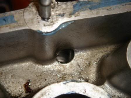

    This is the drain. It is in the centre of the back of the head. The drain runs straight through the head, straight through the block and into the sump.

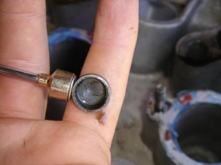

    And this is the plug:
    and this is how they were when I pulled it apart:

    Thats not a plug thats a shim for your buckets which the cam runs on to push the valve down. Check to see if all your shims are there. Was the engine really noisy, tappet wise?
    Aerial Superpony Domestic Engineer SeptemberSquall's Avatar
    730
    OMFG that's not a shim i mean look at it FFS it's concave/hollow.
    It looks like a welch plug from the back of the camshaft. Check the tail end of the camshafts each and tell me if they've both got something like that in them. I'll bet you're missing one. Were you having oil pressure issues at all?

    Im with Michael on this one, looks very similar to the cam welsh plugs

    Oh dear... That seems feasible. I shall check my cams when I get home. It's somewhat fortunate that my cam journals and cam bearings are still OK!
    628
    Thanks lads! It is indeed a welsch plug for the exhaust side cam. I shall get a new one pressed in tomorrow.
