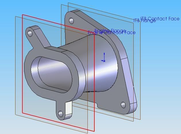

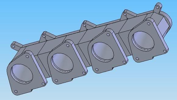

    Default Re: Dimensions of the 20v quad throttle flange?
    This is what I have come up with so far. Took me a 1/2 hour to make this:
    I just guessed the dimensions for the moment, and can easily change them all later.
    It won't look like that in the end as the tubular stuff in the middle will be encased in a solid bit of material to cut down on machining processes. I might need outsource to get the insides done, as I have no 4th axis in the CNC. We'll see.

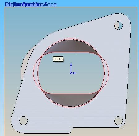

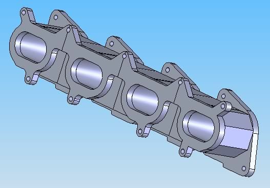

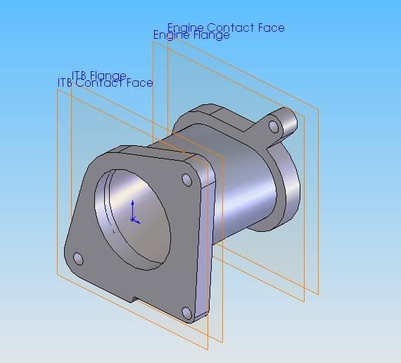

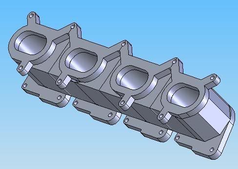

    433
    Ok, I think it is finished for now.
    433
    Final port revision:
