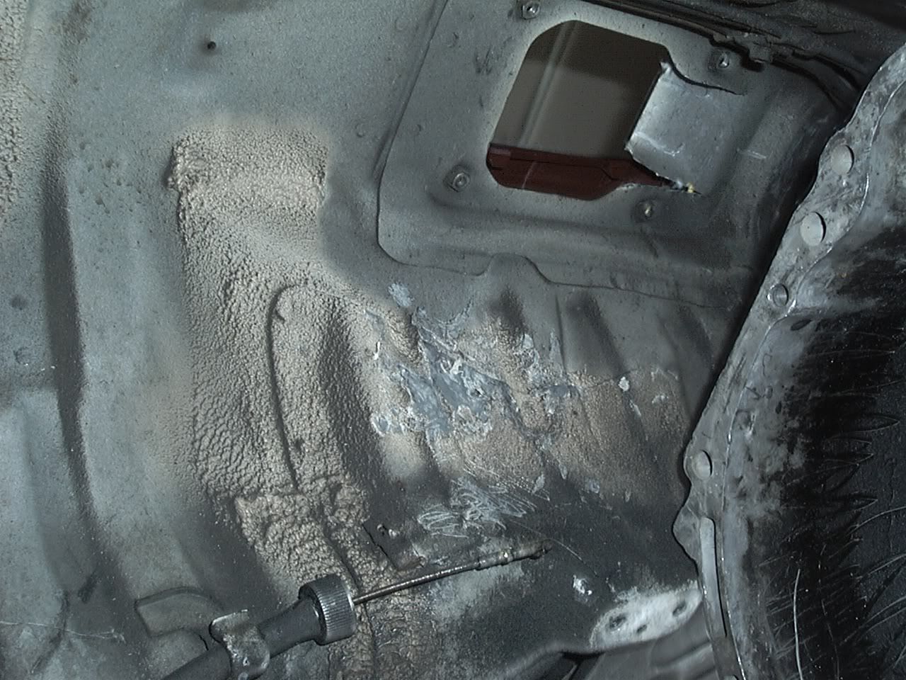

    just on the gear box topic, how much trans tunnel mods need to be done to fit an r154 into an ma61? as in how much would it cost and how much fuking around is it?
    (sorry not trying to hijack)
    1,811
    Default Re: What's this missing bit?
    Cost = 1 sledgehammer.
    Have a bit of a search on www.celicasupra.com - there are pics of what needs to be hit.
    Quote Originally Posted by gianttomato
    so u just bash the crap outta the tunnel? nice hope the console and stuff does warp lol
    1,811
    It's called selective massage. Hopefully your console would be tucked away somewhere safe.
    Picture from this thread showing the amount of selective massaging required.
    JZA61
    Guest
    i just read the whole thing and its soo much fuking around with the drive shaft and shit. i think ill just go jza80 w58. lol
