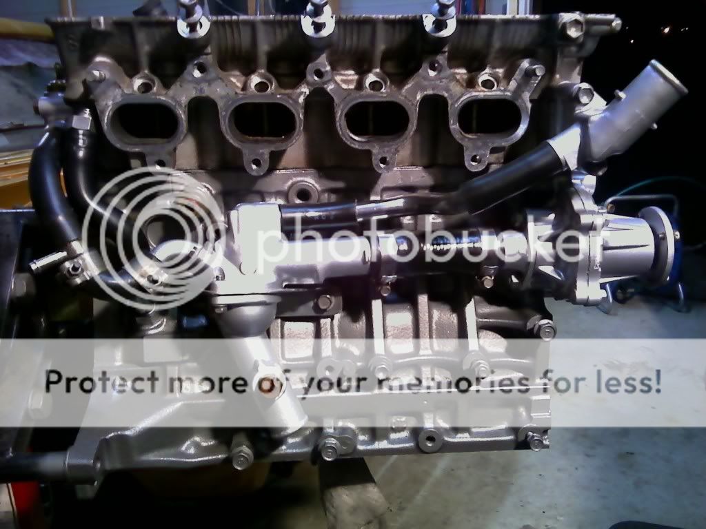

    Ok thanks. I have managed to track down this one from i think an ae92.
    Should do the trick hopefully.
    Any advice for piping or mods that you can see would be great

    If you compare your pics to the link I posted, you'll find that your one is the AE82 version. I can be used, but its a PITA to mount as one of the water pipes points out the side instead of the back. This means that pipe would be pointing at the block instead of the back of the engine (where it takes water from the back of the head) so you cant mount it on the block inline with the waterpump, unless you can get a tight 90' bend on it, but I think you'd be pushed for room.

    Yep I asked the guy when i picked it up and he said ae82. I see what you mean about the 90' bend. I figure i may aswell pop it in unless i can track an ae92 one down but no one seems to have one.
    Was thinking of setting it up either like the one in this link http://www.toymods.org.au/forums/thr...tures-included or i'll try set it up similar to yours bit with a solid 90 or 110' bend.
    So just trying to get my head around the setup. The main hose leads to the bottom radiator? Then there are two that come out at a similar point. Big one leads to water pump? The smaller one leads... Top radiator hose? and then i have the one coming out at a 90' bend. Guessing that leads to the heater core?
