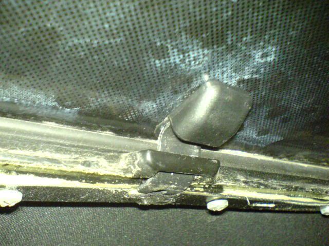

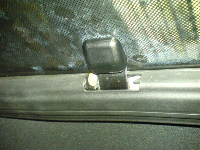

    Got a little bit of a dilemma with the sunroof (pretty common i've heard). This problem came with the car but has become more annoying now. When i tilt the sunroof up, one of the braces that holds the glass inside the car always slips out so when i close it it leaves about a 5mm gap.
    The brace sems to be snapped off as you can see here...

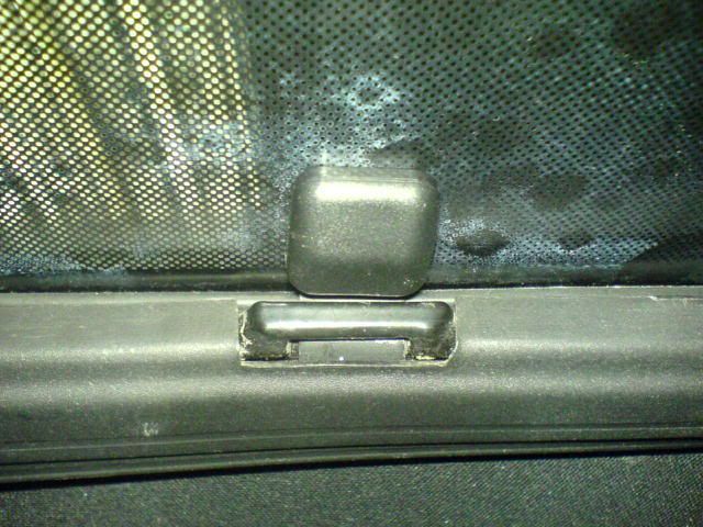

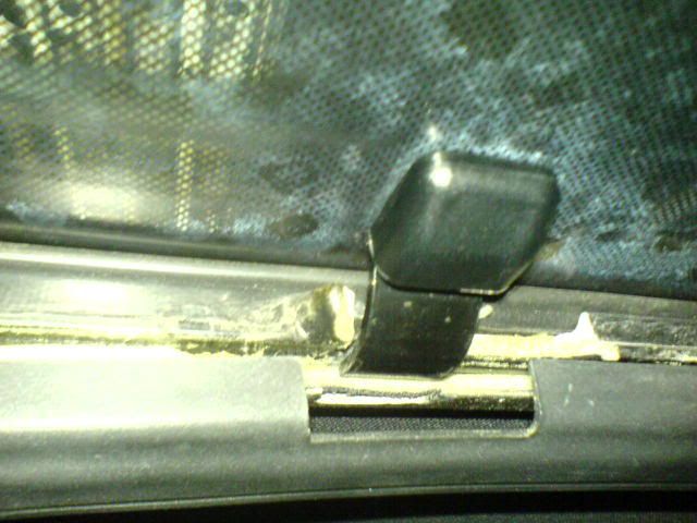

    Here is the one that works fine..
    http://i99.photobucket.com/albums/l2...i/DSC00013.jpg
    http://i99.photobucket.com/albums/l2...i/DSC00016.jpg
    Any ideas on how to fix this?
