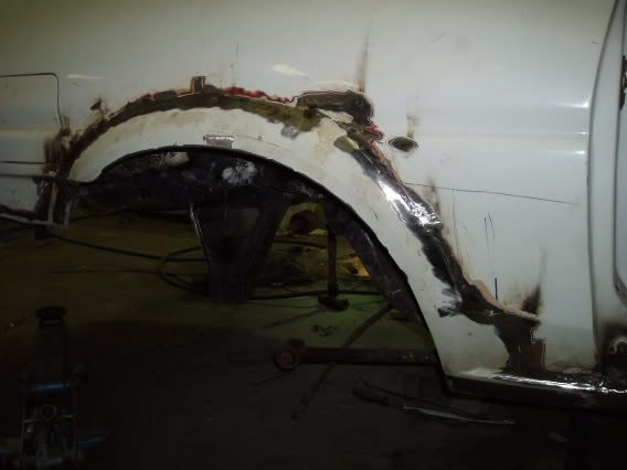

    i have this to add
    i did this myself. it is a new section cut from a donor car and but welded. the 1/4 pnal sank ALOT. some taps with a rubber mallet on the sill and it popped back out mostly but the bog is still upto 3mm deep in places. i think thats too much weight to add to a race car.
    if you do weld, have a compressor with an air blower in one hand to chase the welds as you lay them.
