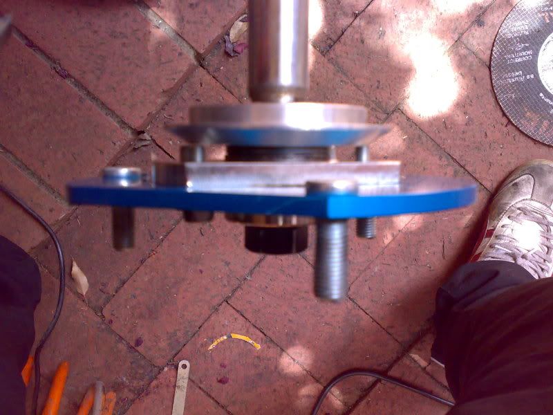

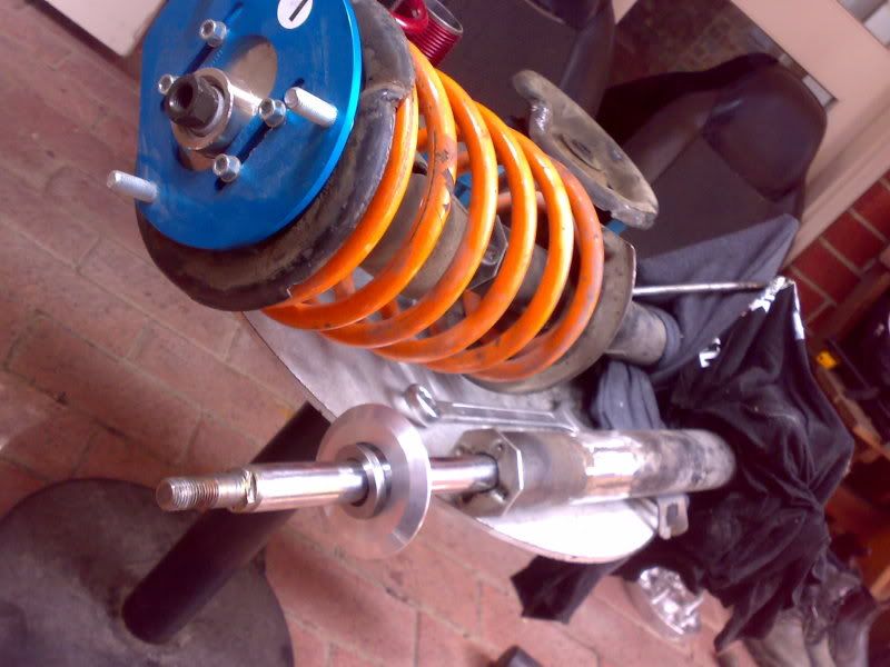

  7. #682
    863
    Default Re: [Guide] Corona/Peugot/Hilux Conversion with Height Adjustable Coilovers [56k DIAF]
    dammit! my hats are fitting over the strut!
    this isnt right is it?!
  8. #683

  9. #684
    863
    yeah t3...
    so is it good or fucked?

  10. #685
    6,193
    Quote Originally Posted by SillyCarS
    yeah t3...
    That's just how they roll.
    The upper hat ID for the strut is larger than the strut OD, the strut is able to pivot at the spherical bearing, the hat rests on the underside of the camber top and the strut is able to go through its range of motion inside the oversized ID hole in the upper hat.
    Once you've run it let us know if you get any gauling from the interference between the upper hat and strut, I'm sure there would have to be some as nothing locates the upper hat.
    I looked into these for mine but they wouldn't work on the inverted Bilstein design as the strut slider OD is way too large.
    Their method is good but the execution is flawed.
    My KE25 thread
  11. #686
    863
    how fuckin shit is that
    i have cusco tops and a little spacer thing to prevent this and even that fit through the ID of the hat
    wtf?! who are these people that design these things, i think i may have to make my own hat
  12. #687
    6,193
    Good hey...
    Put your gingerbeering skills into practise and make something.
    I'll post pics of the ones I am making shortly (strut tops).
    My KE25 thread
  13. #688
    863
    it looks like if i shorten the screws in the adjustable top that all may be sweet
    EDIT: on second hand, even though unlikey nothing is to stop going over a bump and that little bearing bo-jigga from popping out
    i'll get the 1mm grinding disc out and see how i go
    also note that this is with the spacer ring provided by cusco
  14. #689
    6,193
    Hang-on, are yours the T3 upper hats with the needle bearings (called the upper hat system on their site)? i.e. the upper hat needle bearing rests on the underside of the camber top allowing the spring to rotate as you steer.
    Once you cut the threads what does the top hat seat on? the shaft spacer or the bottom of the camber top?
    My KE25 thread
  15. #690
    863
    yeah they have the needle bearings, its not just when you turn either, when the spring compresses it wants to rotate
    it will sit on the bottom face of the camber top if i cut the adjustment screws
    i could remove the spacer, but ive decided to leave it the as i dont want the nut sitting directly on the slots cut out of the side of the end of the strut
