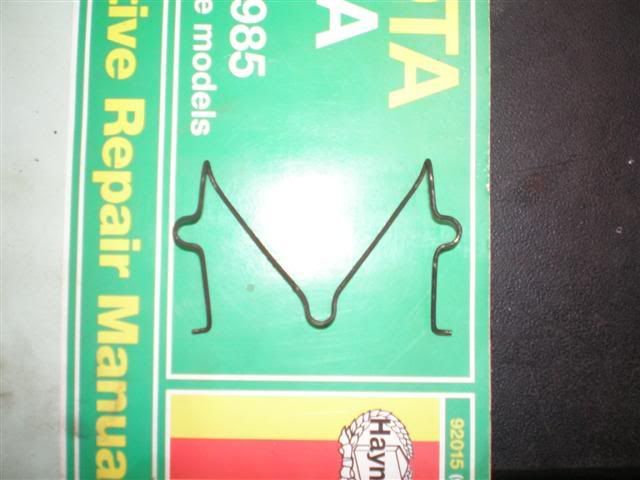

    does anyone know where i can get some more of these springs?
    i only have 1 and need 4 right?

    Cant remember the name but one of the 4WD stores on ebay sells them, send a few messages to the stores and ask around, its one of the bigger stores i think.

    You need 1 per caliper

    I have 2 per caliper
    You dont NEED them as such, they were put there from factory, they make it easier to hold the pads in place when sliding the caliper over the disc. You can get away without having them fine, I just used them on mine just cos i had them.
