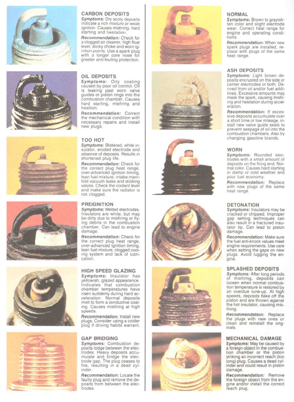

    Does this pic help?
    The electrode on cyl 5 on my 1JZ is often white too. Too lean? Clogged injector?
