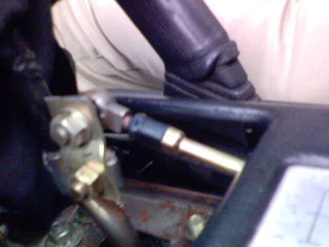

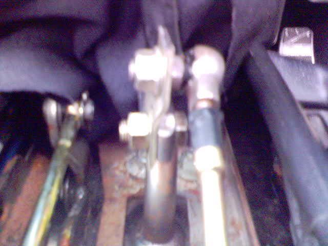

    I don't know if anybody has been doing this to there AW11 shifters, but thought I'd post it anyway, its an easy way to make your own shortshift
    Just a simple bit of plate steel with a small curve in it and 2 holes, 5 min job, it made a very big difference.
    [IMG][/IMG]
    [IMG][/IMG]
    I modified my shifter last night ,works very well

    Default Re: AW11 shortshift mod
    Don't get too carried away with the height change or the cable will foul on the console.
    If it does, you can just kink the end of the cable a little and it still works fine
    Yes very true, I found my max cable height by pushing the cable to replicate 2nd ,4th and reverse, then lifted the cable up towards the console so it was just clearing, I had the additional made bracket bolted onto the shifter beforehand ,so all I had to do was mark with pen where to drill for the cable and that seemed to work well

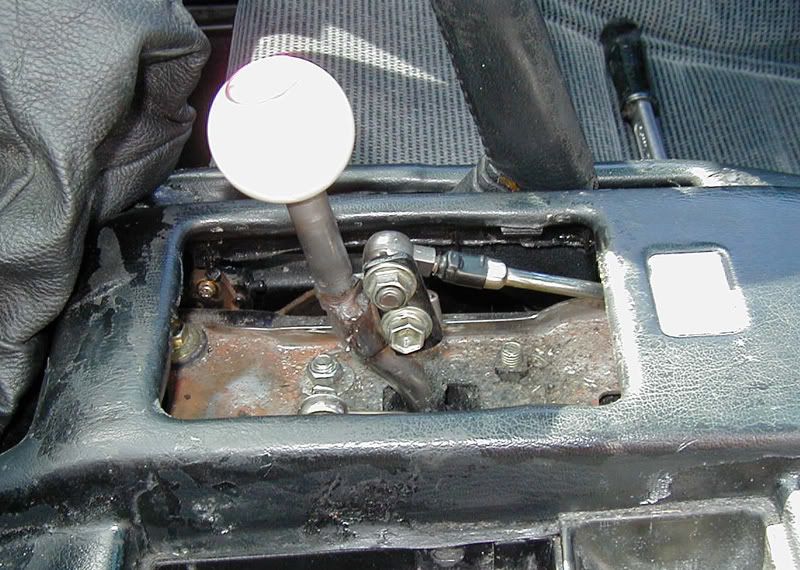

    here's mine....
    diffinatly made the throw shorter between gears, and the wierd thing is the shift doesnt seem as notchy anymore either...
    Hey Feral, is that piece of plate steel thicker in the first pic to get the shifter lower so the cable will have better clearance to give you even more adjustment in cable position on the shifter?
    sorry long question, but am I right, or is that plate there for some reason?
    Yes the plate is there to drop the whole assembly down about 8 mm.
    Me and Cam did this to his AW11 today. Made the throws shorter and just like feral, Cam said that the shifts are nicer, not as notchy and feel more precise now! Go figure.
    By the way, we didn't put a bend into the metal plate. Just a piece of straight scrap metal.
    Feral, thats a smart idea spacing the shifter lower like that. Means you can raise the hieght of the cable higher without it fouling the consol and have even shorter throws!
