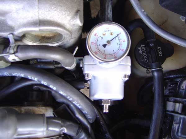

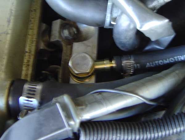

    My MX83 had these exact same symptoms. No power when cold.
    I fixed it by repacing the fuel pressure regulator with an adjustable one and I reduced the pressure. Too much fuel pressure when cold causes the car to run very rich. When rich, the flame speed is very slow and so it will only have power if you advance the timing. However as soon as it starts running off the O2 sensor it comes back to a normal mixture and then starts pinging.

    Nice ****** Grease Monkey rvrolla's Avatar
    121
    Default Re: 7MGE Better Fuel Economy
    Interesting with the FPR, does it actually run any more efficiently with it? I never have hot start problems at all, the only thing I need to do is run a relay to the starter motor as it is not getting enough juice sometimes.
    I found that if I back my timing off, it is a pig when cold and seems to ping worse under little load..
    649
    My car has run much better since changing the FPR, no more giant plumes of white smoke at full throttle and no clouds of white misty smoke after those early morning cold starts.
    More recently I replaced most of the exhaust system. car now runs really well. It's hard to say for sure if I have seen much improvement in fuel economy although drivability is now greatly improved and I have seem to be enjoying the extra zing by putting my foot down a little more often. The 7mge loves to rev now and its sounds great.

    Whats involved in changing FPR? How do you know what to set it to?

    Quote Originally Posted by rvrolla
    Can anybody see anything bad with this? I know the 7M's run super rich in standard trim, my fear is we change the fuel pressure and I'll start detonating... BHG

    649
    I gradually reduced mine from about 44psi with the toyota FPR to about 32 psi with the adjustable one. I set it by periodically checking the fuel trim at the diagnostic connector until it gave an average value of 2.5Volts. Which according to the manual means little or no fuel trim is being done.
    It started off at zero and slowly moved up through 1.25V to 2.5V. Now Iv'e stopped fiddling with it and its settled down nicely.
    [IMG][/IMG]
    BTW the FPR has a little vacuum line on it to increase the fuel pressure during high load.
