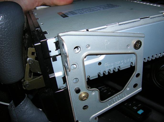

    I have a factory rolla pocket and pioneer CD which bolt nicely to the side brackets.
    My problem is I cannot see how the bracket is meant to line up in the car.
    The car was missing it's brackets, are all AE82 brackets the same?
    Pic of bracket attached. Am I missing another piece?

    Default Re: AE82 Corolla stereo mounting
    thats all it is, one of them each side of the radio
    they usually go on a little like this
    the radio ahs to go at the top, pocket at the bottom. the way you ahve that bracket in your pic, is the top and bottom, looks like you photo'ed the right bracket
    Heres what I mean, brackets were from another AE82.
    First pic is of stereo area in car.
    Second pic is of stereo RH bracket lined up against car.
    I must have the wrong brackets? confused now, need to see another AE82
    Yep, totally wrong brackets.
    haha sorry man, dunno what i was thinking, i see now, its been a while since i had my ae82. and i was the same, i had no brackets with that, i made my own, just a couple of bits of galvanised sheet screwed from the side to the radio, just an L shape bend
