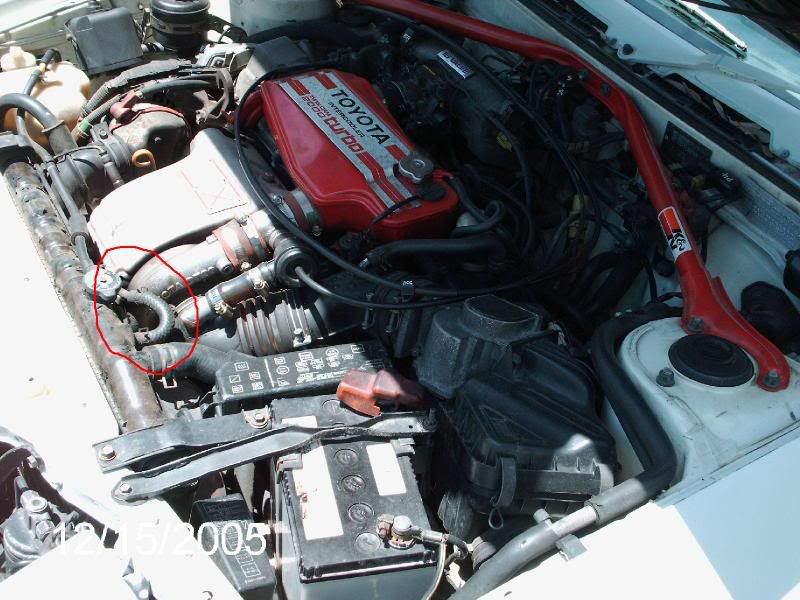

    On an st165 the turbo water hose connects onto the top tank of the radiator. there's a special join on the radiator in the gt4's.
    i'll try and get a pic for you
    879

    AUST 162 Cheers buddy, looks like i cant use that fitting then
    Hmm Might have to T Piece one of the other water pipes to return the water then.
