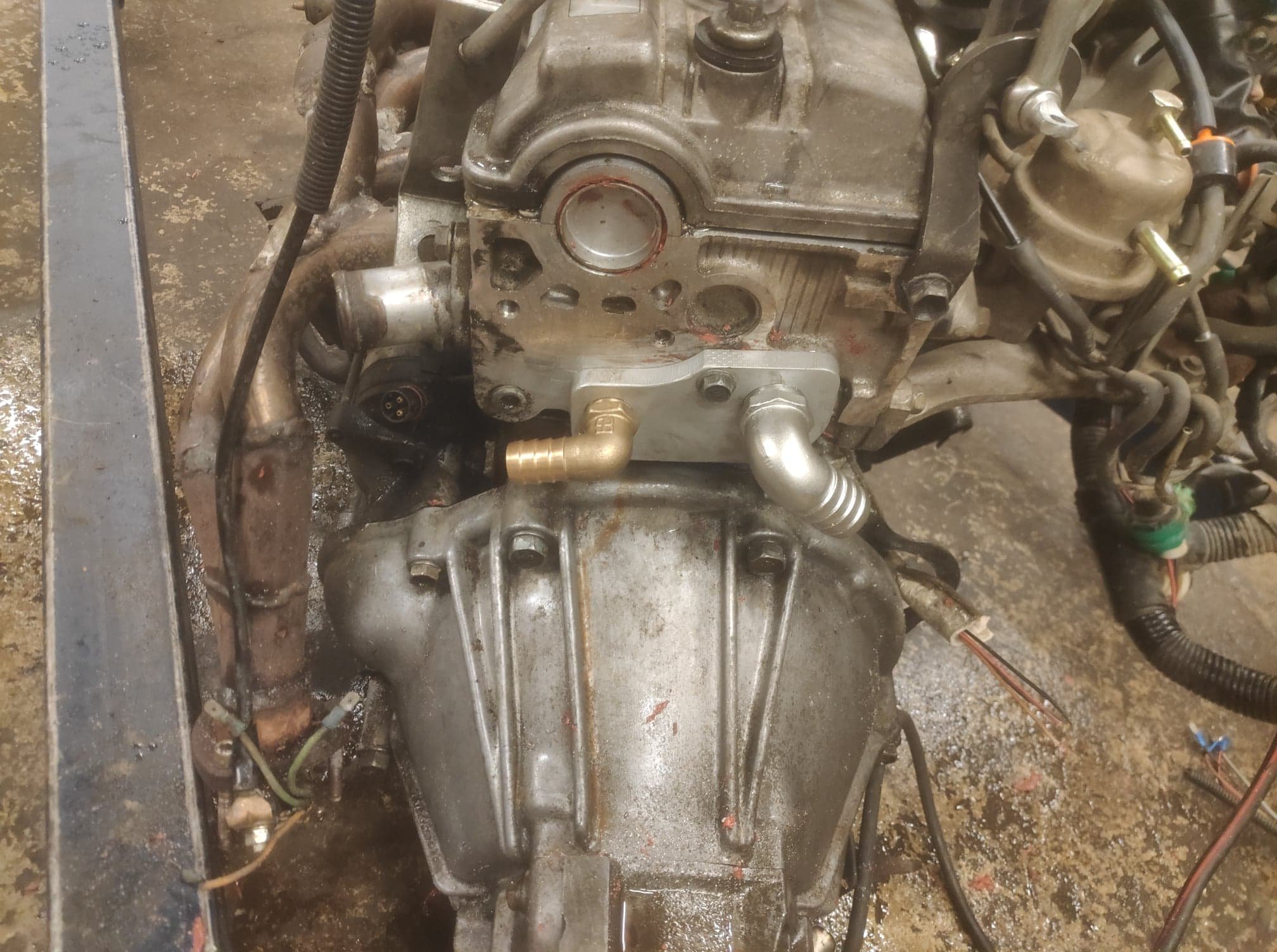

    1, water/thermostat housing is taking quite a bit of space towards the firewall. I solved this by relocation it to the side by some VVS and aluminium plate, and so far I have not notice
    any problem with this solution.

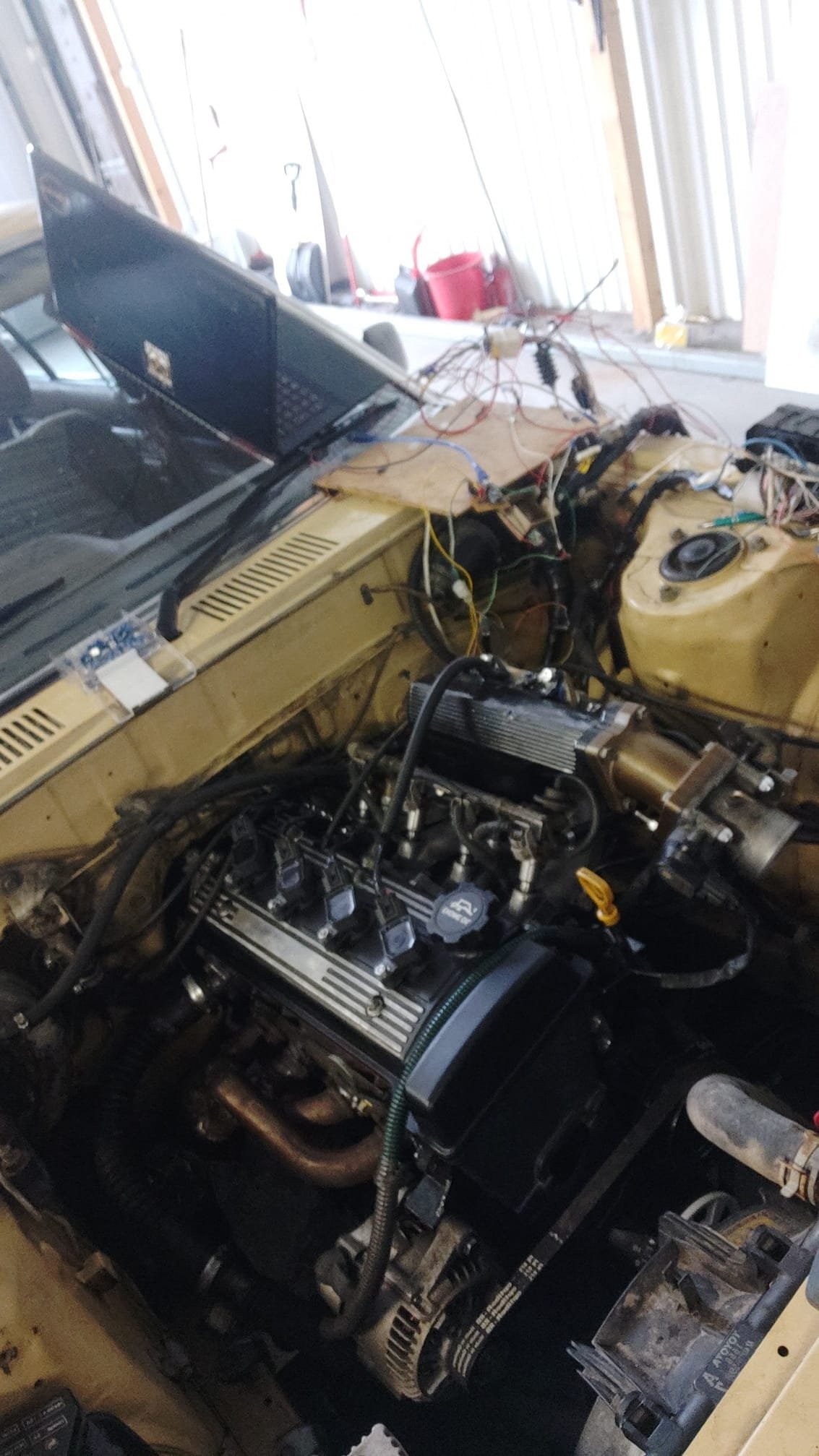

    2, i, most problematic thing with these engine is the distributor/ignition system which also will hit the firewall. I have gone through several solutions to this problem. Relocating it to the
    cam sprocket and run it in reverse and switch 2 ignition coil locations (looks weird but works), however mine setup was 3D printed so broke after a while..
    ii, second option was to remove the sparkwire/ignition coil from the dizzy and use the "halfsmart" system of toyota which will send IGT and IGF signals from the distributor to fire the
    sparkplugs. These signals was bypassed by a arduino to "sniff" the fire signal (IGT) and with the help of 1 tooth reset on the crank and a mosfet card fire coil on plugs in batch. A
    transistor drain was use to fake the IGF signal which was a bit of a headache to get right. This worked quite well but sometime at high RPM lost power, think it might have been me who
    coded bad that cause this.

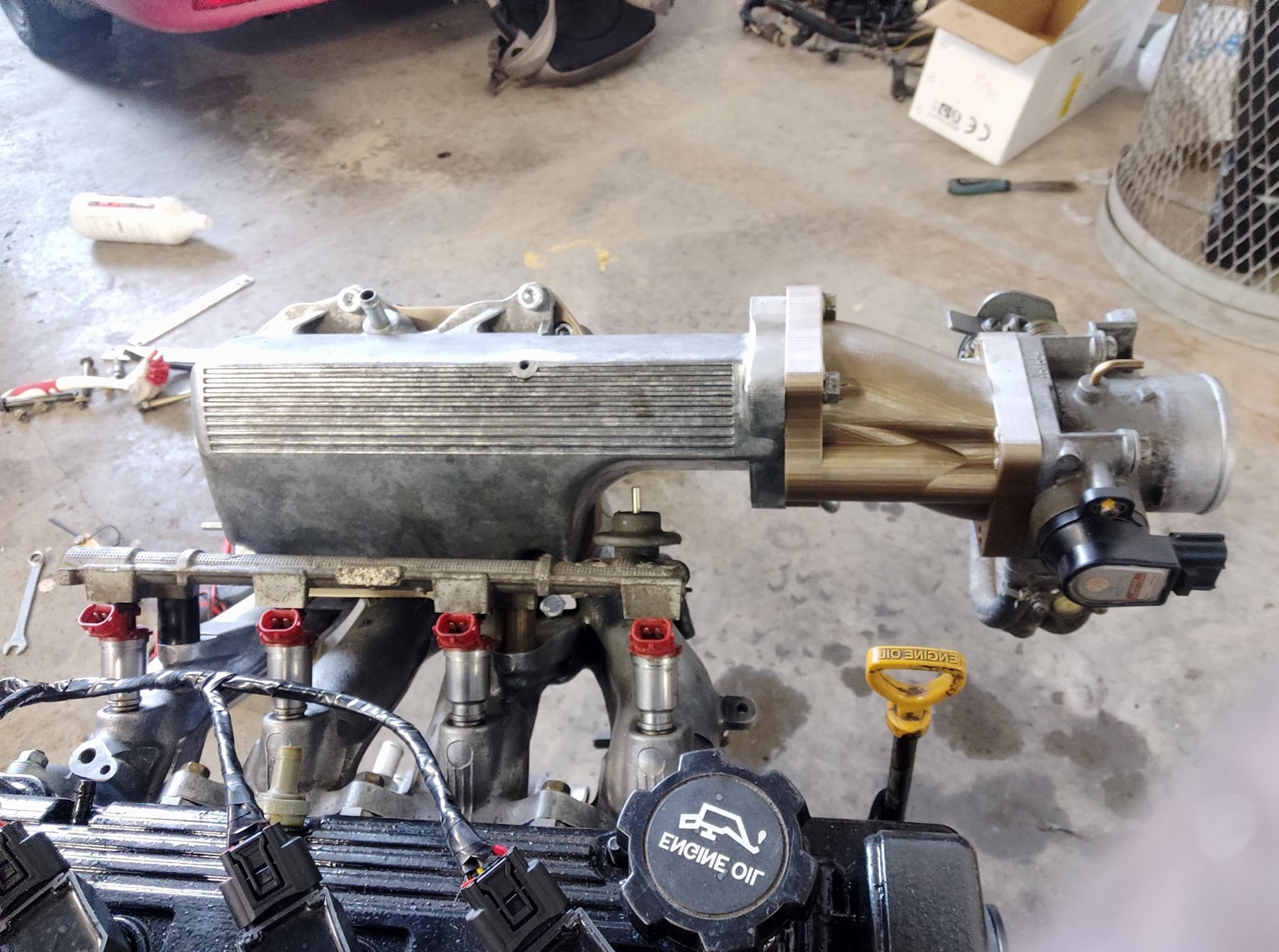

    3, Intake direction, tried a couple of solutions to this.
    i, 3D print top part of intake, 3d scanned and printed top part of intake which gave quite a good possibility to improve airflow and worked for about 2 weeks until I got a backfire and the
    the whole thing exploded.
    ii, 3D print a adapter to 180 degree rotate the intake top part, was a simple solution that worked but airflow wise I think it was quite bad..
    iii, re-weld the neck of the intake to the other side. Finally bought a aluminium welder which made this possible and is the best solution however how these gen 1-2 intake are made it
    was still hard to get a good airflow of the relocation.

    Waterhouse relocation for this engine is the same as for any of the other FE, so far all FE engine have the same pattern except gen 1 of the 4AFE.
    So same solution was used.

    Intake of these engine are also a bit difference, its a solid aluminium pendlum which uses a vaccum activated valve to turn of 1 of the 2 runners to each cylinder. (this increase swirl and tumble and give this engine a bit more torque at low RPM) However the pendlum is quite a bit better design to reweld also, wo by cutting the back side and front side and switch them I manage to get a good intake as well. Its not perfect fit though som some filler aluminium was needed to seal this.

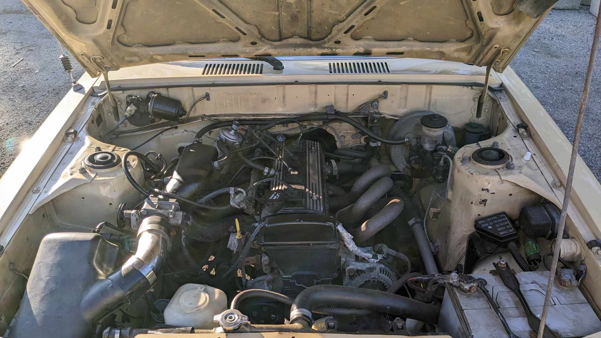

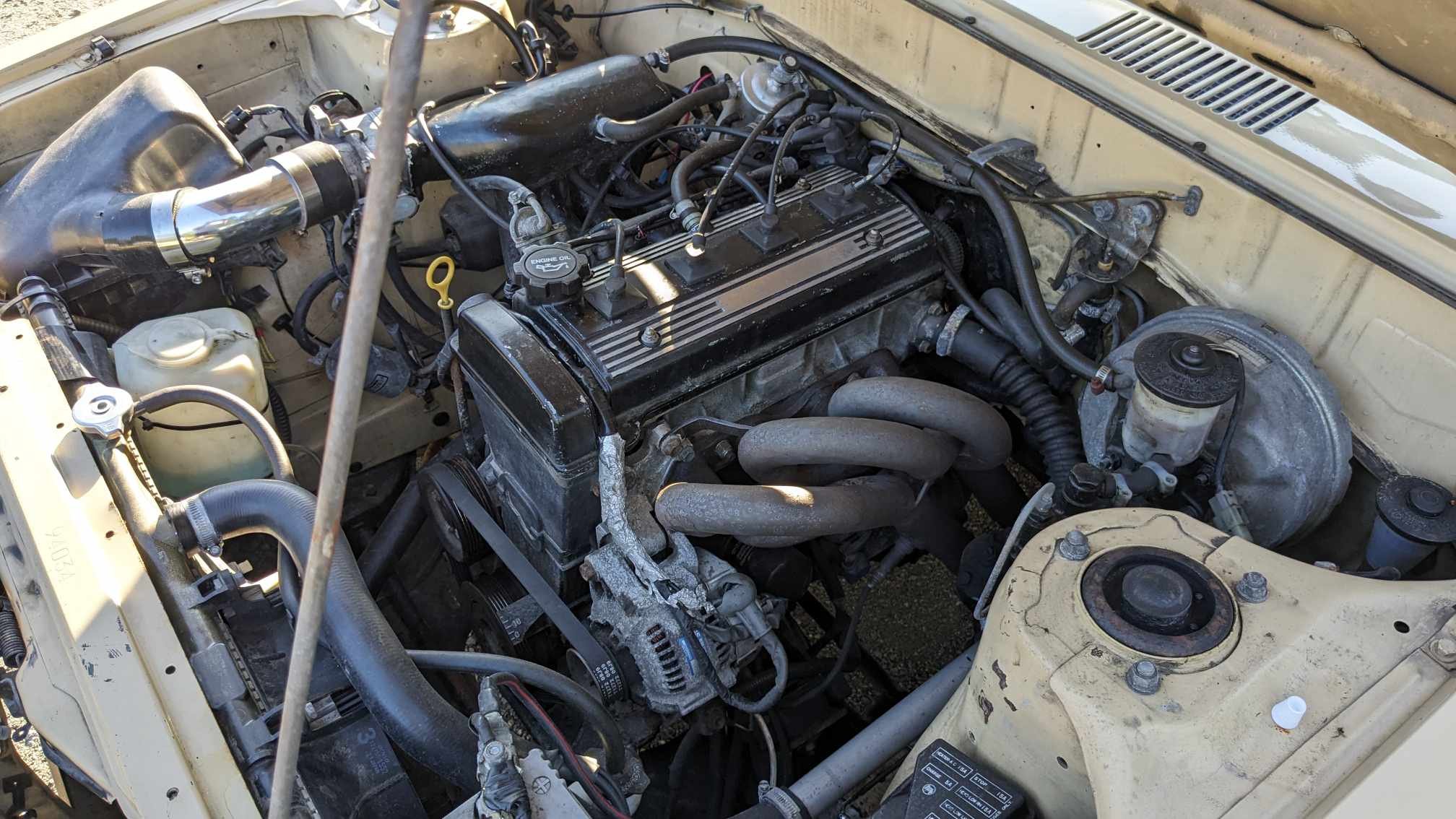

    So here is how my setup looks now, not super clean but:
