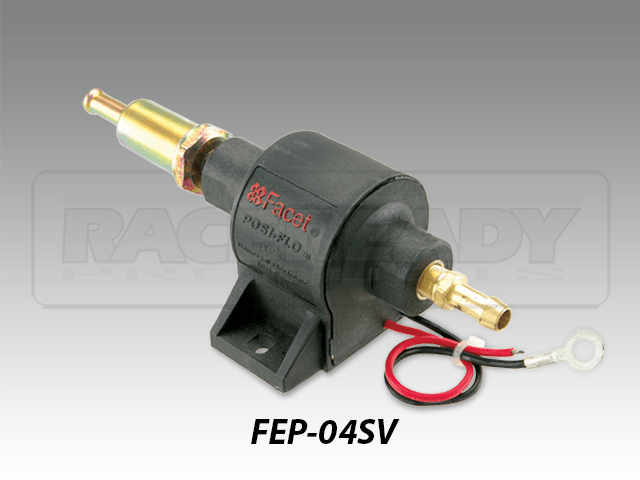

    What options are there for a small discrete fuel pump for the solex carnies? Do I need a simple pump with just a line in then out? the current efi fuel pump is in the boot and is huge with heaps of fuel lines coming out of it, too messy for my liking.
    I think the pump needs to be no more than 4 psi and can it be mounted in the engine bay?
    I was thinking of this one http://www.racereadyproducts.com/fue...flo-fuel-pump/
    Some say facet pumps are noisy...?

    Quote Originally Posted by 72GT View Post
    Facet pumps are noisy. We used to call them rattler pumps. I usually use a rotary vane or roller pump such as a Carter. http://www.summitracing.com/int/part...4070/overview/ but you will need a pressure reg. I used this model pump, feeding twin Webers on my rally/ daily car for just over 6 years with no problems. Usually pay about $95 to $110 AUD depending where you goto. Best to fit in engine bay near carbies, as in a TA22 near original filter position. (Edit) Also good idea to have filter between tank and pump, used to use a metal body filter.

    Default Re: 2T-GEU EFI conversion to solex carbies
    I run a soft mounted facet pump located in the trunk beside the fuel tank. Yes it is noisey when priming the carbs (reasuringly so actually) but not noticeable once engine running.
    Have a pressure regulator/stop valve switch/tilt switch in the engine bay.
