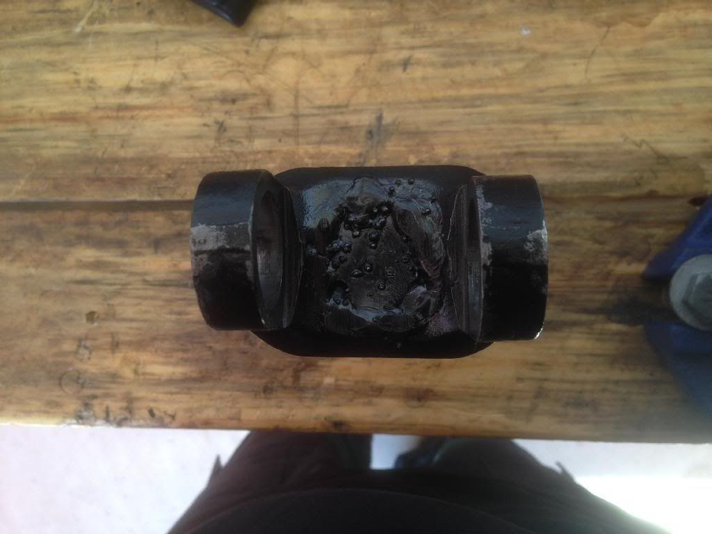

    Thanks for the suggestions fellas. This was the issue...
    The yoke itself was twisted at the unis and had twist in the spline section as well. There were also no bearings left in either front or rear uni, just metal powder.
    Methinks I need larger unis to deal with the power output so am on the hunt for a g-series pinion flange that will fit an f-series mx13 diff. If anyone has a spare mx83 2 piece tailshaft lying around, i'm looking to purchase one. Or a yr22 centre with the larger flange.
