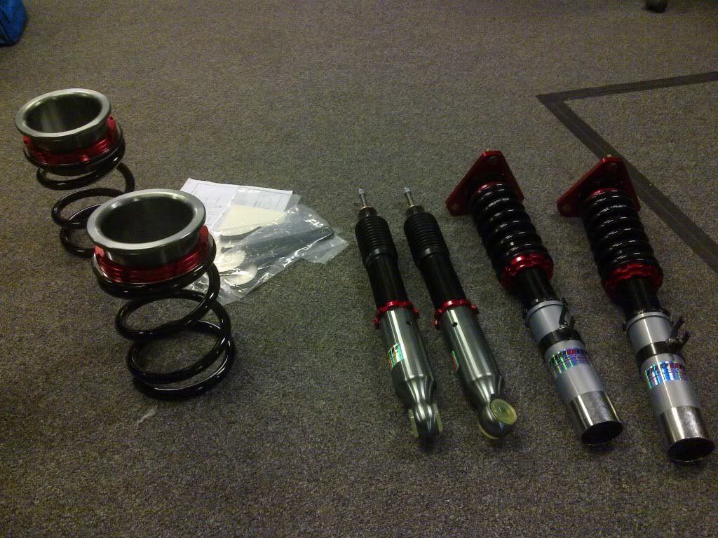

Out of curiousity, have you got a photo of the BC kit for MX73?
Every photo I've seen online is for 'illustration purposes only' and wouldn't suit the MX73

cant find the bc ones, here are the megans [courtesy of coff33]
more pics of the megans: http://www.celicasupra.com/forums/sh...MX73-Coilovers
