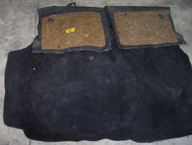

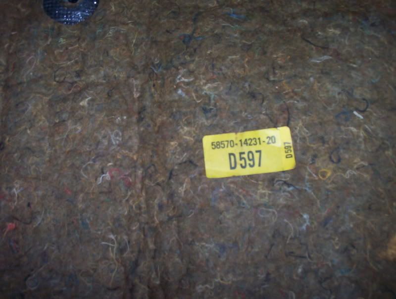

    MA61, RA65, Rear carpet .... part number : 58570 - 14231 - 20 ( Black )
    Project: '82, GA61 XX
  8. #128
    2,158
    Default Re: MA61 Part Numbers & General Infomation
    Cheers, added. Along with the SuperPro diff x-member bush number.
    I take it you didn't buy that new!
