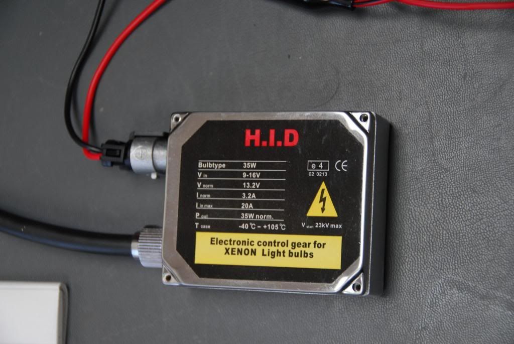

    So I purchased this no-name generic 35W / H4 kit about a few months ago for around $50.
    The first thing I found right out of the box was one of the units rattled, oh yeah that’s not good :/

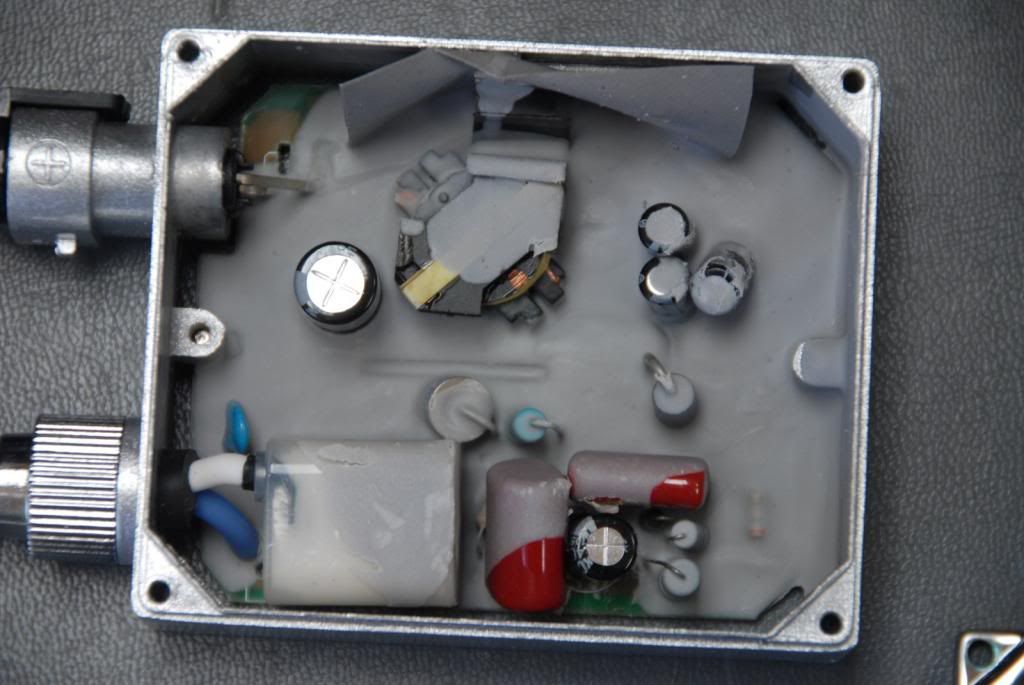

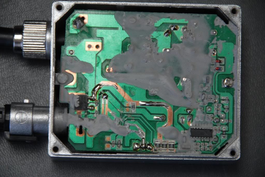

    Upon disassembly I found there was a 4.7uf 400v capacitor that had broken off the board & was noticeably swelled up at the base. Some awesome QA there…
    Anyway I bought a few replacements from RS & soldered a new one in, I also removed & inspected the other larger 1000uf 25v capacitor.
    Here is a shot of the board. The broken capacitor was the one amongst the 2 big red poly caps in the HV circuit.
    Track Side, the soldering was pretty terrible so I fixed up the worst joints.
    The silicon goo was actually pretty easy to remove & could be brushed off with-out damaging the SMT components. I plan to re-seal the board with PCB lacquer prior to installation.
    The larger components really need to be stuck down better with silicon or potting compound.
    The power FET is wedged onto the case heat-sink with a spring clip against the switching transformer. This is not a very well made board… But at least it’s easy to fix!

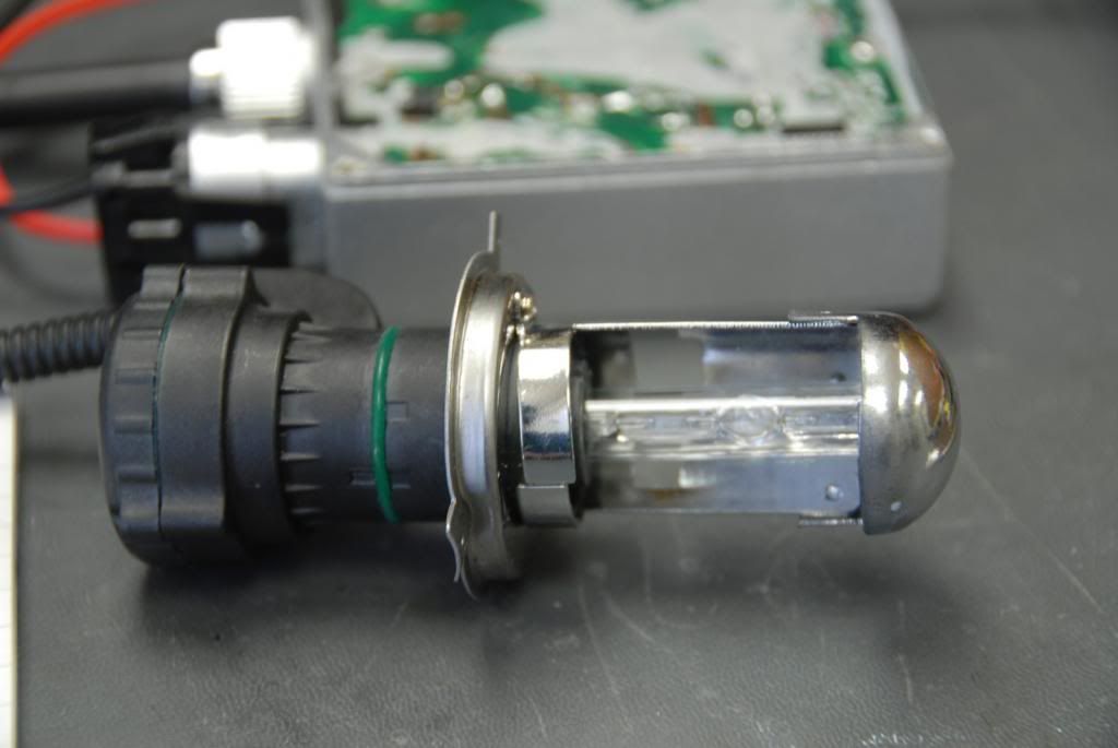

    The lamp is a combined HI-LOW H4 unit which utilises a solenoid arrangement to pull the lamp into alignment with the gap in the reflector shield to act as the high beam mode.
    The connectors appear to be fairly standard for all the china kits I have encountered.
    2 sealed high voltage lines & the small ‘high beam’ connector for the solenoid.

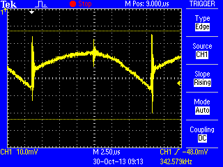

    For my test rig I used an 8A 12V linear bench supply with a 0.1ohm 20W resistor in series with the ballast circuit for current waveform measurement.
    I had loan of a Tektronix TDS2012B storage scope to make the readings.
    Running the unit at 12v has a very brief spike up to 25A <25us then stabilises at 3.93A within 10 seconds or so. The lamp reaches full brightness within 30 seconds.
    Inrush spike across 0.1ohm resistor lead at x1
    It will keep running down to about 8V, the current gradually increases to ~5A, where it will eventually flicker & go-out.
    It won’t re-start till the voltage is removed and higher voltage is re-applied.
    It will start at 9v reliably, but the brightness stabilisation time is longer.
    Running it up to 14v the average current decreases to 3.2A.
    Current ripple at 12v/3.9A:
    It generates a fair bit of switching noise, but probably pale in comparison to ignition coils.

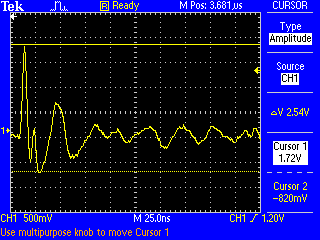

    Voltage ripple:
    The audible noise is almost non-existent, which is surprising given the ‘quality’ of the board.
    Many other units I have seen are quite buzzy when powering up from cold.
    I inspected the voltage on the lamp supply where the defective 4.7uf cap was attached to, this only rose up to about 70v, so I’m not too sure why they have an oddball 400v cap there.

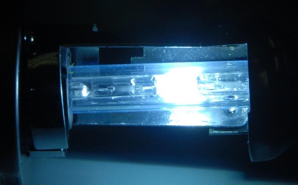

    Despite the build quality it appears to perform quite well, the lamp starts first time every time without sending the power-supply into current limit.
    The lamps are very stable with no flicker (though will be interesting to see how this goes on-car).
    The case gets a little warm after a few minutes of use, but not concerning amounts.
    Close-up of the running lamp, UV filtered:

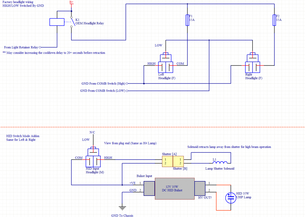

    So after analysing the requirements & looking at the Toyota wire diagrams, the whole lot can be made far less complicated while still maintaining the redundancy of independent lighting circuits.
    BAM!
    Minimal wire mods, maximum awesome!
    The only extra wire required is the chassis ground fly lead, make sure to clean off the paint & ensure good solid connection.
    I always use a dab of conductive joint grease on the bare metal & terminal when connecting. It’s good stuff & prevents the connections & bodywork going rusty.

    Fortunately MR Toyota was also aware of the issues of moving hot lamp filaments & incorporated a lamp delay system into the retractor circuits.
    This part is currently work in progress, but I intend to modify the delay circuit for an extended cool-down cycle before the lights are retracted, watch this space!

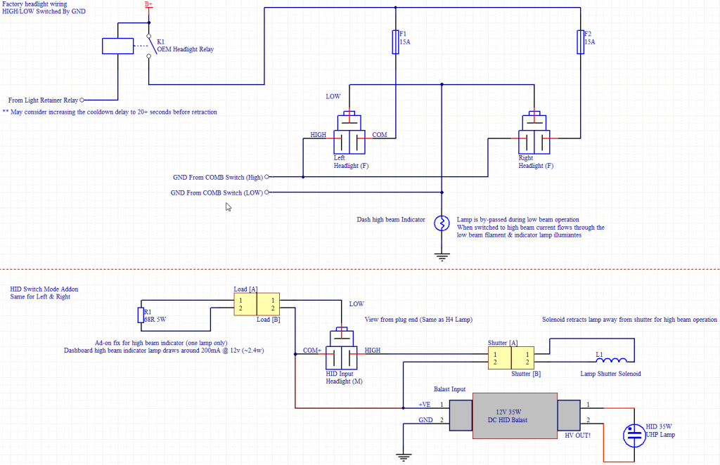

    When I did mine I added a resistance in the form of an old relay between the low beam control wire and the common power wire so that the high beam indicator will work.

    Good idea, I haven't tested the high beam indicator yet, noted.
    669
    Default Re: HIDs for Dummies, A review of E-bays finest.
    It may seem a bit strange having the high beam indicator connected to the low beam wire but that is how it works.

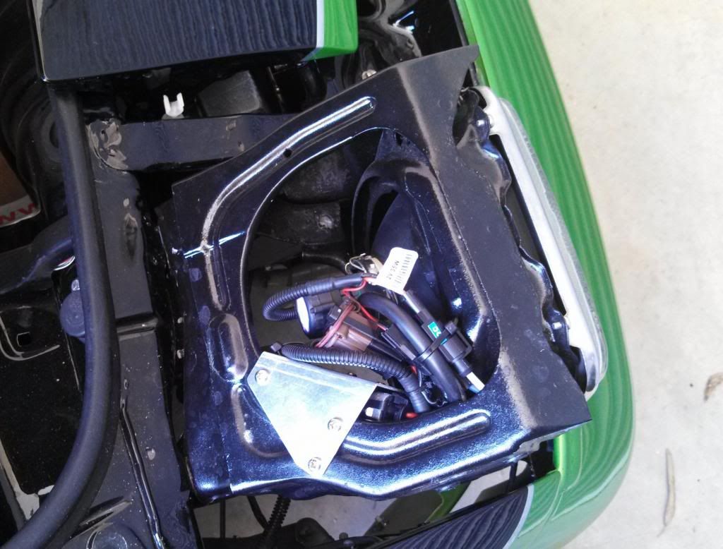

    Finally got some time last week to finish off the installation.
    As madmont noted you do indeed need some resistance between the low-beam and common for the high-beam indicator to work.
    One of these very strange toyota wiring oddities...
    See revised OEM to HID circuit:
    All the bits tucked up inside the light lid:
    Still yet to mod the retractor relay, but I am sure it wont be too difficult to increase the cool down delay.

    I am a bit doubtful about the 68 ohm resistor. Bear in mind that when the lights are on low beam it will have 14v on one side and earth on the other side.
    Jealousy is a curse
    Jun 2008
    252
    Yer the resistor is a bit of a hack...
    I measured the current flow through the dash high beam lamp to be about 200ma ~ 2.5w @ 12v
    The resistor will need to be at least 5W to make sure it dose not burn!
    I am thinking I will replace the indicator with a suitable blue LED (next time I have the dash out).
    This way I can increase the resistance to about 750 ohms & not need to worry about baking stuff! (part of the reason it is on a separate little plug)
