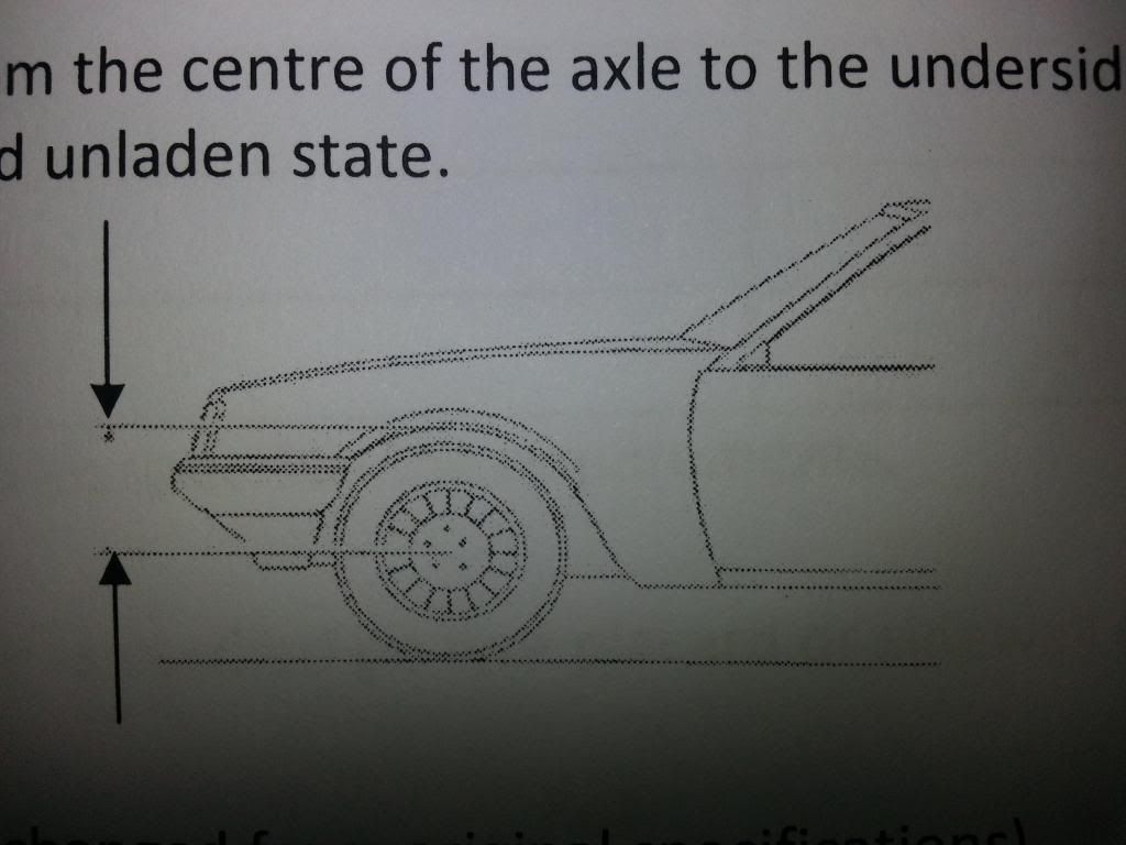

    Does anyone know of the standard ride height for an MA61.
    Measured from the centre of the wheel to the wheel to the flare. ( refer to pic )
    I need to know for vehicle modification reasons.

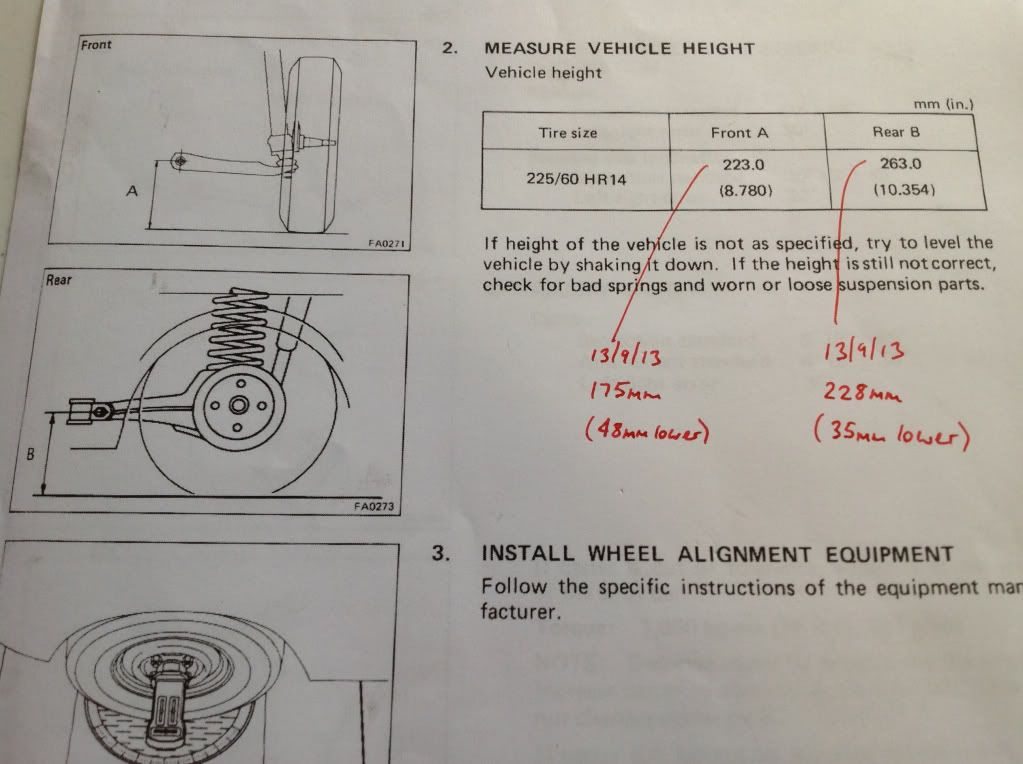

    Can't help with eyebrow height but there is this measurement
    Quote Originally Posted by 82MKII View Post
    - Patrick
