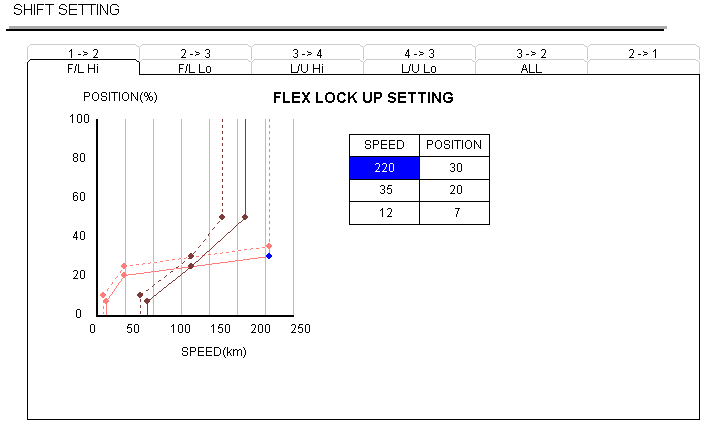

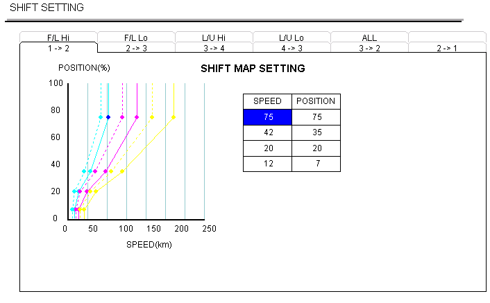

    Mv Autos has said I need to turn the convertor lock up off in second and third gear leaving it on in 4th only. Also have to change the shifting hrtz from 50 up to either 100 or 200.
    Just not sure how to do that.
    Will have a look at the settings compared to what you just posted.
    Thanks again.

    Settings I posted is default.
    Here's another screenshot:

    "Flex lock-up function: This mechanism distributes transmission of mechanical and hydraulic pressure derived motive power in accordance with driving conditions, in particular raising transmission efficiency at low speeds and thus contributing to an improvement in fuel efficiency"

    Hey mate. This is the settings that its got on there at the moment. Link is to a screen shot of the Power FC datalogit.
    http://img827.imageshack.us/img827/6149/c6y2.jpg

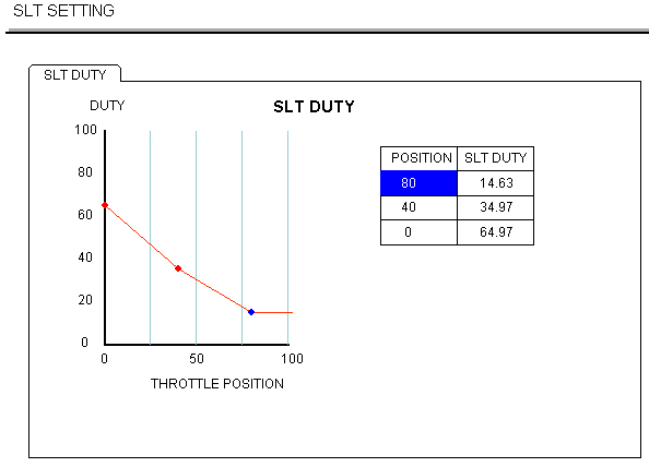

    Default Re: Jzx100 power FC auto issues
    100% default.
    In order to get "SLT duty" (0-100), divide "Setting" by 17.50
    But apart from that, I dont know.

    Yeah that is the default setting that came on the ecu. We have only just been able to access the settings after upgrading to a new version of FC datalogit.
    Silly question but what is SLT Duty?
    SLT - line pressure control solenoid
    SLS - shift pressure control solenoid
    So according to the official graphs, lockup does not occur until 55-65kph and more(?) than 7-10% throttle?
