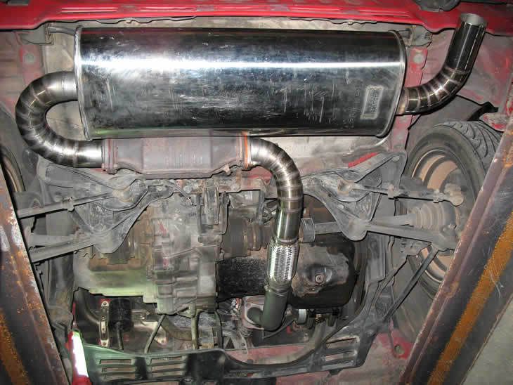

    The exhaust of Rex for His AW11 consists of:
    Its a 2.5inch segmented-bend stainless system with an SW20 Tanabe muffler and stock cat (de-cat for trackdays). The muffler shrinks to 2 inch but logic dictates by this time that is plenty for a 150 odd Hp. The first metre should be the biggest then after that it can smaller with no effect at all.
    When He made it Rex was expecting a bit of volume (Rex dislikes obnoxious road exhausts) He was pleasently surprised that it is only a fraction louder than stock, if that. It has a killer note with no drone, bark or buzz at all.
