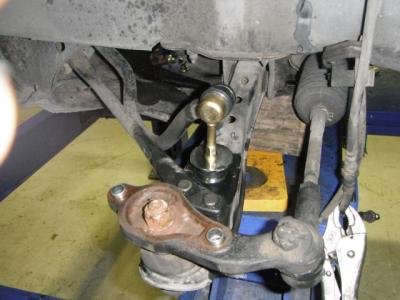

    Started on it today knowing about the spindle having to be welded up, but also noticed... There is no bracket on the new coil over to mount the sway bar? The kit did come with 2 little brackets not sure if they are for this sway bar issue or not. If anyone has done this set up please help!!!

    You use these small links to bolt up the swaybar to the lower control arm.
    There is a small bracket that you use for the brake lines - the small square thing at the bottom of the weld on section

    That makes a lot of sense now, Removed both struts and was about to weld with a friend then seen this issue and put it all back together -_- Why did I not think of this haha... Is it pretty simple just bolting those extensions?
