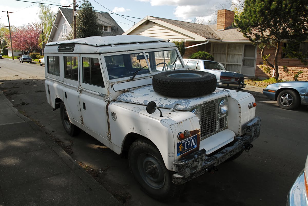

    Also, an exterior or 2nd skin over the roof will give you impressive heat and rain-noise rejection. Old Landrovers used to have a second roof (aka Safari Roof) which worked surprisingly well (example pic)
