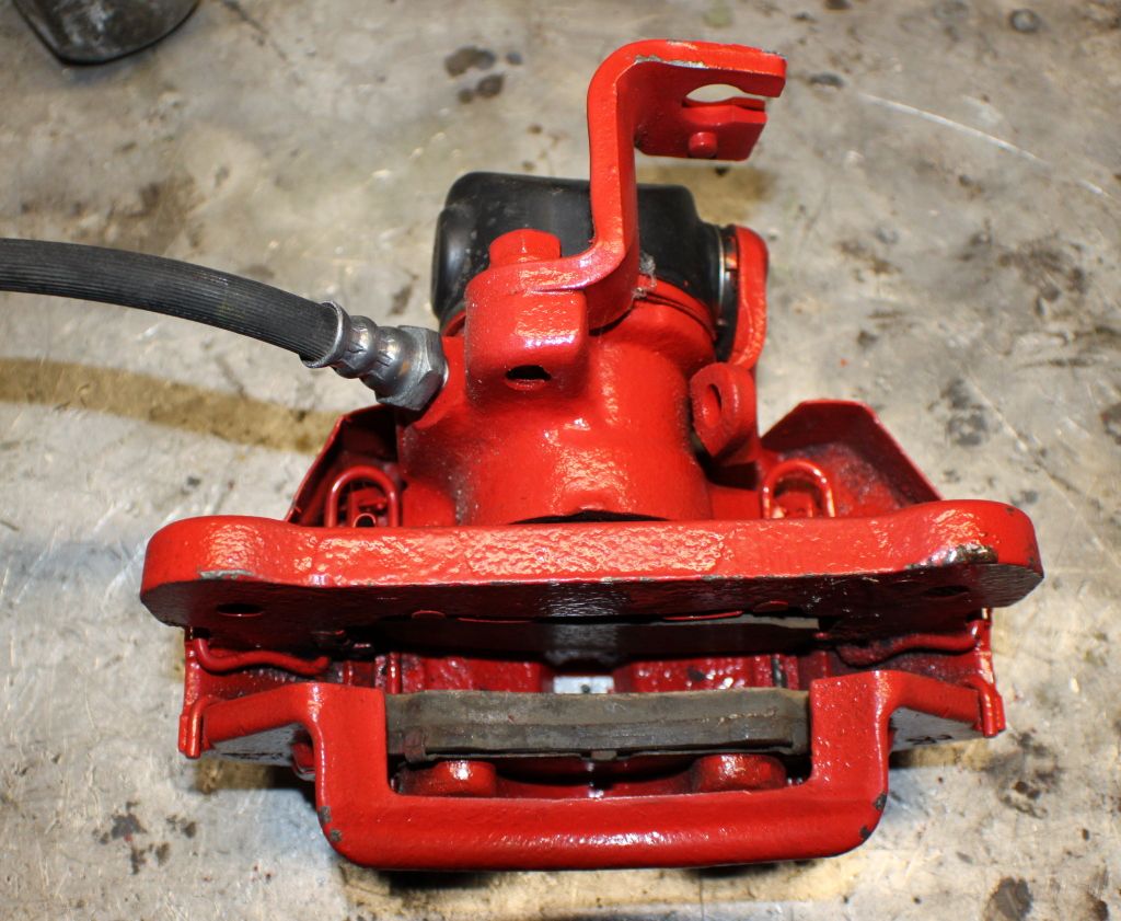

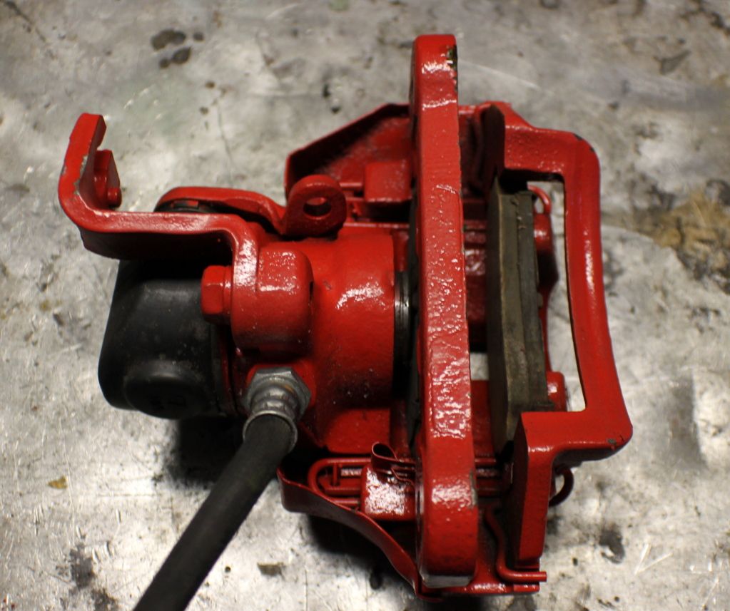

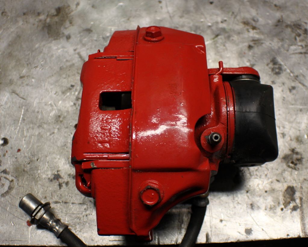

    Can any one identify the calliper in the photos? IT CAME a t-series rear end . It was supposed to be a JDM unit. But upon inspection it appearS to be moded T-18 t-series drum housing & axles (24mm)., 4.1 c/p with a Kaaz LSD . Has JDM AE86 rear discs and handbrake cables , but caliper mounts have been re- drilled and calliper is not JDM rear off a AE86.
    Are they Corona ? And so which model ?

    i have a complete t series at home with these calipers. i was told it could be ma45 or te71.

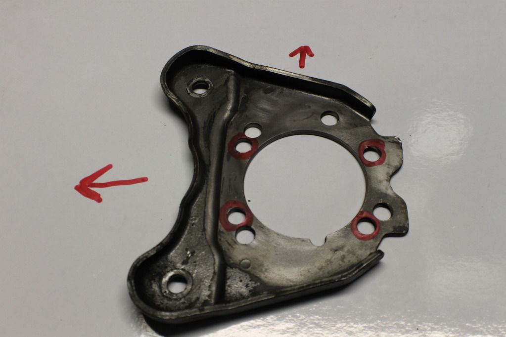

    The calipers bolt staight up to the bracket , It is the 4 mounting holes to the diff housing that have been redrilled (holes with RED circles ), refer to photo . There are no spacers at all . As You can see new holes are not as wide apart and allow the caliper to sit in line with the diff , original holes angled the caliper up or down with regard to the diff. Also when I 1st looked at the pads in the caliper they appeared a bit different to normal pads in late model AE86 rear calipers , but I tried them and they will fit.
    You never know till you try things AH! Orderd a set of road pads for sons rear late model rear AE86 calipers the other day and when the arrived they marked as Mitsubishi Galant /Lancer. They fitted and worked perfect and only cost $49 for a set of 4.
