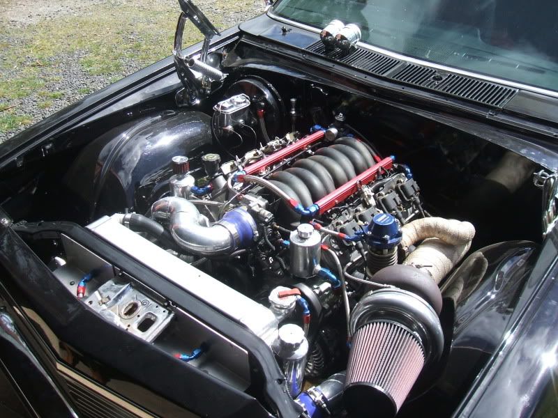

    id love to get my teeth into the fabrication work and also create a cool inlet plenumn too!!! i do all my own stuff in that respect i love to create!!! this is my other project that has just been completed......hope im up tot the task to work on 4cylinders lol
